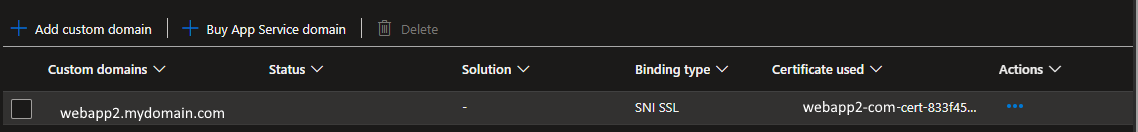

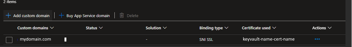

In the custom domain, I can see the web app that does auto rotate expired certificates references the KeyVault certificate name, but the other web apps only reference the Thumbprint.

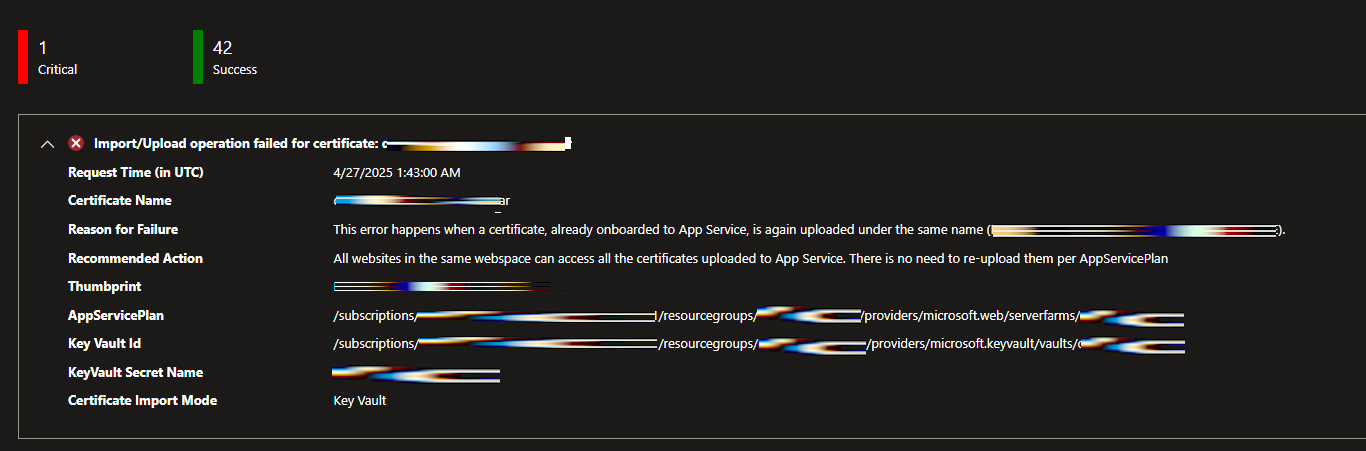

However, on the web apps that have manually referenced the certificate by the Thumbprint when binding (the cert cannot be "imported" again to the same App Service plan as the thumbprint cert already exists), then the keyvault rotation does not automatically update those web apps.
There doesn't appear to be any way to actually link these other web apps to use the "keyvault linked certificate'.
Why are these web apps not automatically updated to use the new certificate when it is uploaded into the Key Vault?

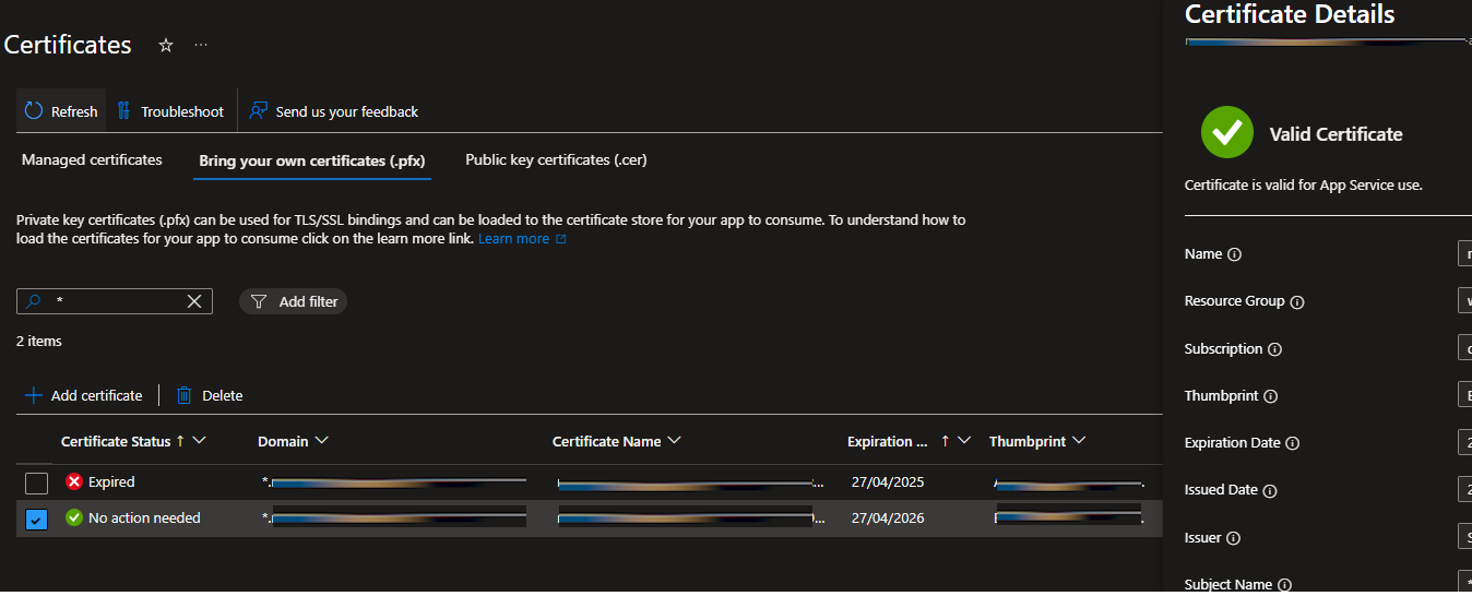

    1. Certificate is listed under each of the web app. Both web apps have exactly the same view of the certificate. The second web app (mywebapp-698754321) also has "Sync" button on the certificate detail.
    2. I tried creating a new version of the certificate and disable the old version. The web apps (mywebapp-598764321) did not pick up the new version automatically. I could click "Sync" from one web app (mywebapp-598764321 or mywebapp-698754321) and the other web app will pick up the new version of the certificate.
    3. App Service Plan does not have any setting on Certificate. You need to select the App Service to set the certificate.
    Is it possible for you to remove the certificate and add it again from one of the web apps? The other web apps using the same App Service Plan should pick it up automatically.
