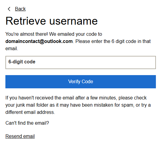

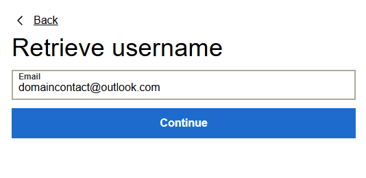

    https://dcc.secureserver.net/account/retrieve
    2. A one-time use PIN will be sent to your domain's contact email, enter it on the screen and click Verify Code
    Your username(s) will be displayed. Make note of the username. If there are multiple usernames displayed, you can use process of elimination to remove known usernames/customer#s for other GoDaddy accounts you may have.

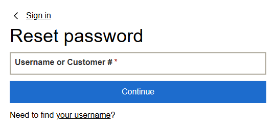

    https://dcc.secureserver.net/account/reset
    In box, enter your GoDaddy username/customer# from previous Retrieve username screen and click Continue:

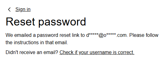

    It should show the contact email obfuscated with message saying it sent password reset link:

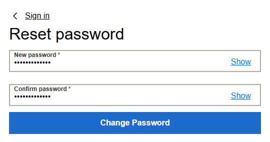

    Please click link in that email and reset password:User's image
