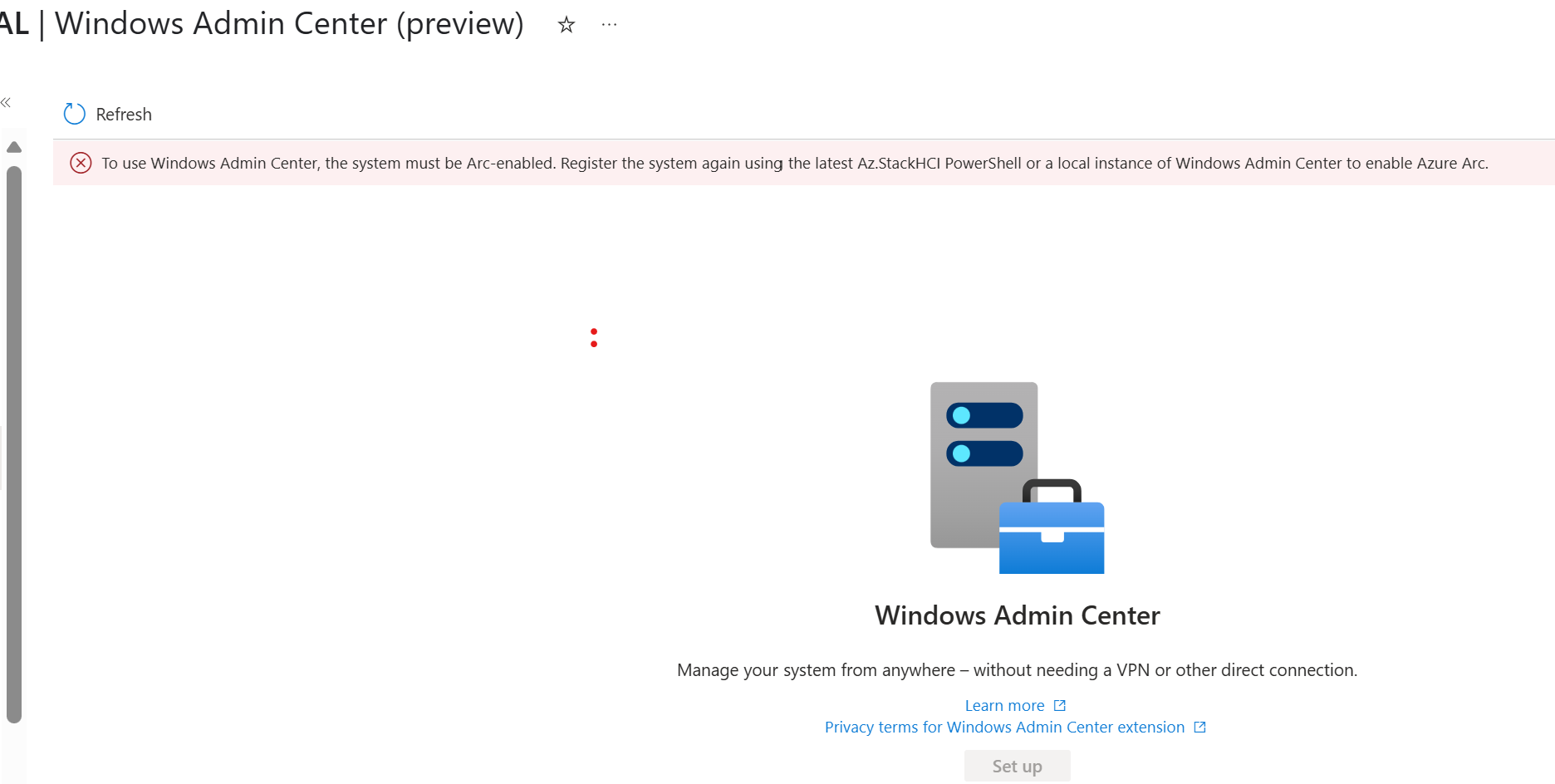

How can I resolve an issue with the following warning displayed at WAC?
Tried registering stack again using "-RepairRegistration" parameter. Everything seems registered correctly. Uninstalled WAC extensions, reinstalled multiple times and still getting the same error.
Now for the interesting part - if I hit "Refresh" the error goes away and I can complete setup. Tried with different user accounts and browsers and behavior is the same.

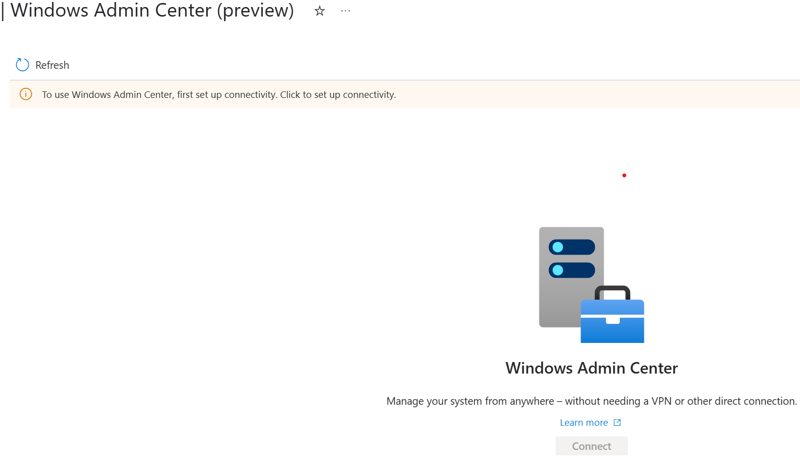

After the extension is installed and setup completed, the same warning persists but "Set up" changes to "Connect".
Refreshing this screen results in another warning:

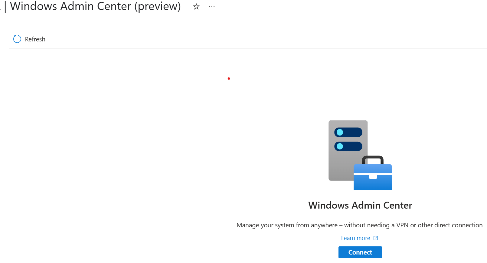

And refreshing once more, the warning goes away. This happens every time when navigating to "Windows Admin Center" in azure portal for Azure Local cluster.
Don't see this behavior for individual nodes.
The actual connection works randomly. Sometimes throws an error saying it cannot connect, sometimes gets stuck in "Starting Windows Admin Center" and sporadically the connection goes through without issues. At the same time, Azure WAC connection to individual nodes of the cluster works as expected, every single time.
