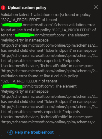

  2. Added Token Endpoint to the RelyingParty block for PasswordReset & ProfileEdit custom policies as was already included in the SignUpSignIn policy.
I have tried including the Token endpoint to the other policies, as mentioned in the documentation linked below in the comments. But have had no luck with it so far.

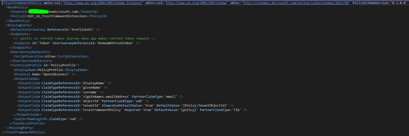

ProfileEdit policy:

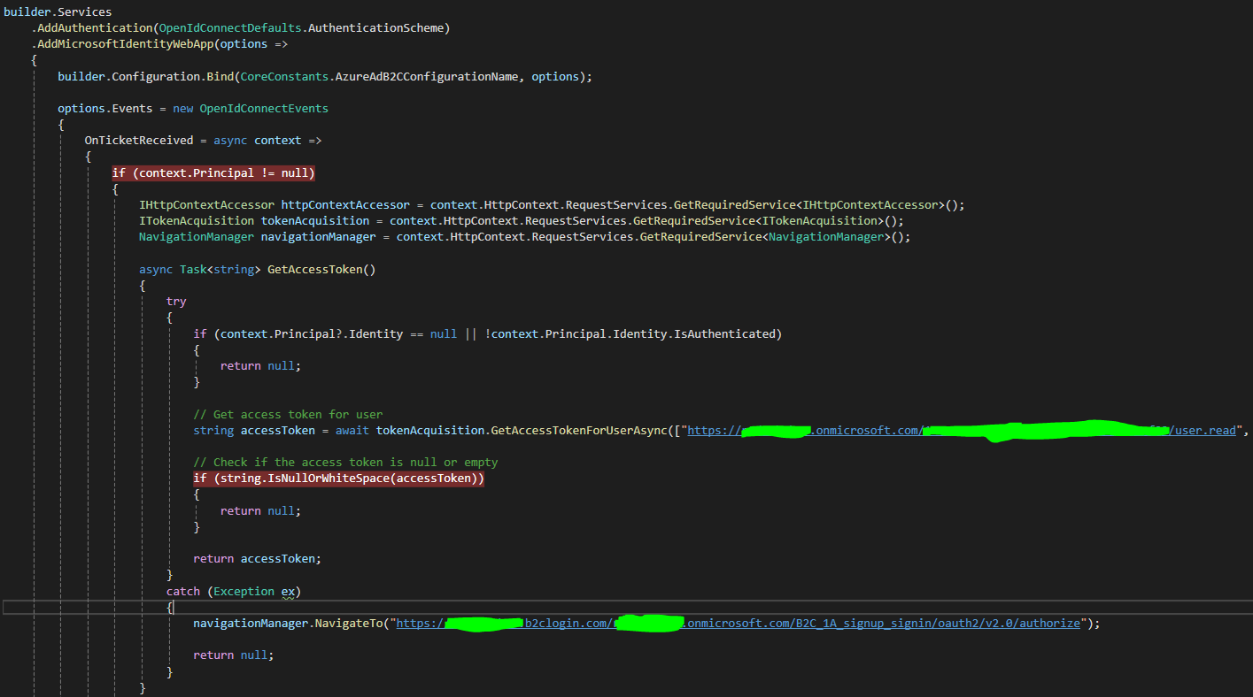

I'm getting an MsalUiRequiredException in my .NET application for the ProfileEdit & PasswordReset custom policies when retrieving the access token:
Access token retrieval is working fine for SignIn/SignUp using the auto files from https://b2ciefsetupapp.azurewebsites.net/, and the .NET C# code above in the screenshot. But both ProfileEdit & PasswordReset custom policies are not working. These were working fine using user flows.
