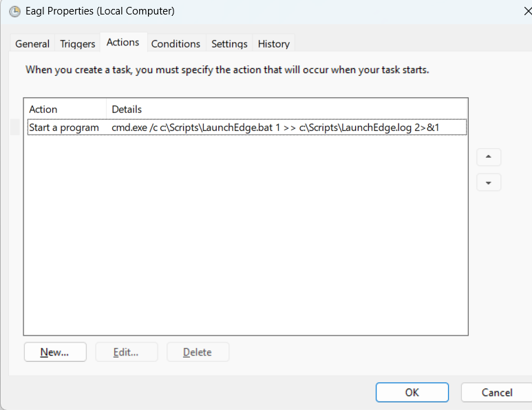

    Then change the scheduled task to execute program "cmd.exe".
    In the arguments field set it like this example:
    /c C:\Scripts\MyScript.bat  1>>"C:\Scripts\Logs\MyScript-%date:~10,4%-%date:~4,2%%date:~7,2%.log" 2>&1
    That will create a daily log file of all executions of the task. That will capture stdout and stderr for programs that get called. Review the log to see what the program did.
    Note the "/c" switch. That tells cmd.exe to terminate after it runs the bat file. If your current task is running a .bat, that might be all you need to add.
    If you don't need to put the date/time in the log file name, then you can append or overwrite a simple name.
