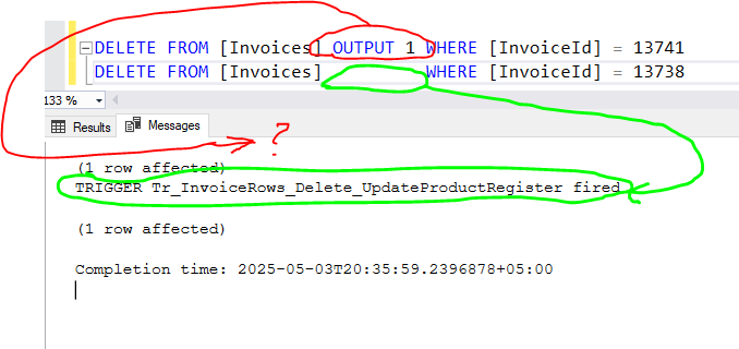

I noticed that the problem is OUTPUT 1 and compared the queries:
enter image description here
I realize that I have many options to fire a trigger on the application side (do not use EF or delete the cascade table rows first or set up the db context mapping .ToTable(tb => tb.UseSqlOutputClause(false))).
I want to know if it is possible to solve the problem on SQL Server ? That is, make the cascading table delete trigger always fire without any surprises.

    If you change the DELETE statement to read
    DELETE InvoiceRows OUTPUT 1 WHERE InvoiceId = 1
    You get this error message:
    Msg 334, Level 16, State 1, Line 51 The target table 'InvoiceRows' of the DML statement cannot have any enabled triggers if the statement contains an OUTPUT clause without INTO clause.
    This may explain why the trigger does not fire in your original example. That is, there is a limitation with using OUTPUT in combination with a trigger. But you could certainly argue that you should an explicit error message also when deleting from Invoices. Silently ignoring the trigger is quite deceivable,
