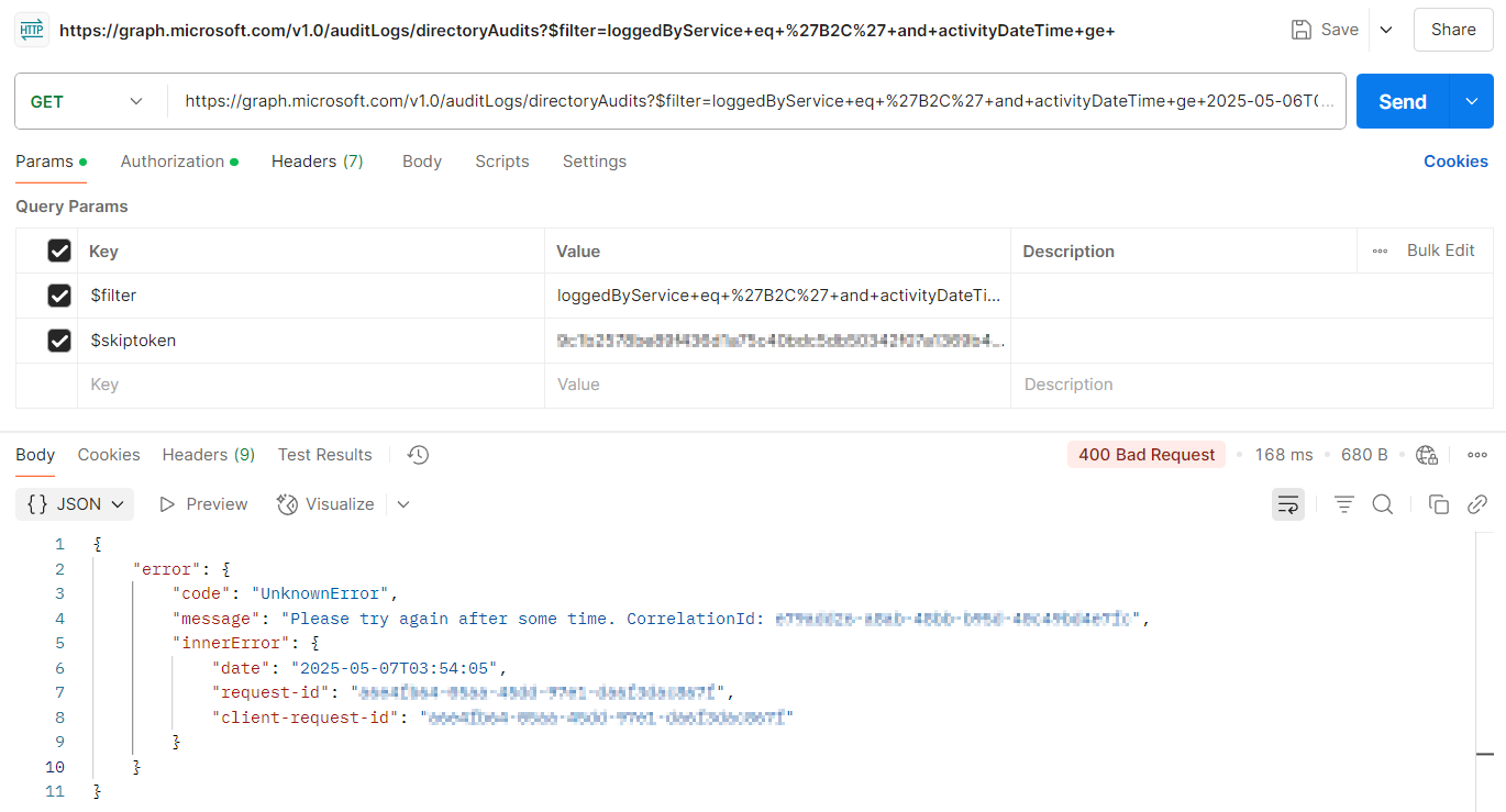

Hi team,
I am using MS Graph API to get the audit log of Azure B2C. The results are normal for the first time, but if I continue to use nextLink to get the rest of the result, there is a chance that an unknown error will be returned.

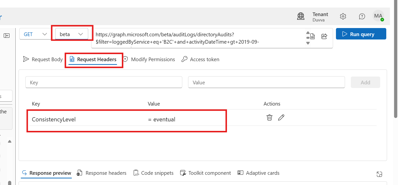

  1. Vigneshwar Duvva 875 Reputation points Microsoft External Staff Moderator
    2025-05-07T14:09:10.76+00:00
    Hello @Allen Yang
    When using the Microsoft Graph API to retrieve audit logs for Azure B2C, it's common to paginate through results using @odata.nextLink. If you're encountering intermittent errors when following the nextLink
    Ensure the nextLink URL is used exactly as provided—do not decode or modify it.
    To achieve this, you need to:
    Select the beta endpoint
    Add $count=true in the QueryString
    Add ConsistencyLevel = eventual to the Request headers
    https://graph.microsoft.com/v1.0/auditLogs/directoryAudits?$filter=loggedByService eq 'B2C' and activityDateTime gt 2019-09-10T02:28:17Z&$count=true
    Reference : https://devblogs.microsoft.com/microsoft365dev/build-advanced-queries-with-count-filter-search-and-orderby/
    Hope this helps. Do let us know if you have any further queries.
