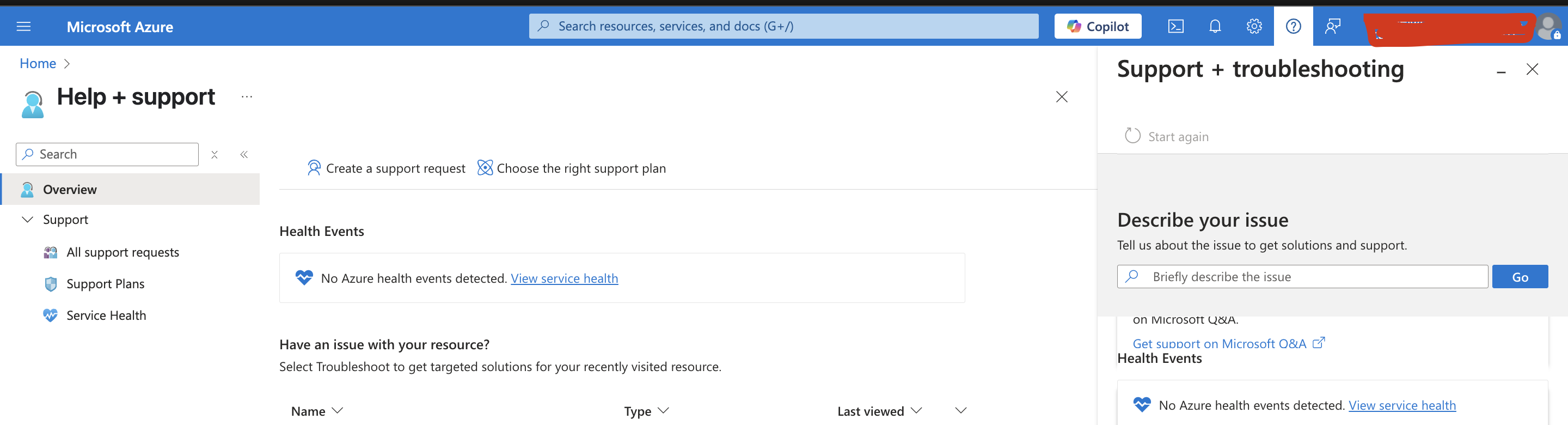

    1. Navigate to this link to start the process:
    https://portal.azure.com/#view/Microsoft_Azure_Support/HelpAndSupportBlade/~/overview
    2. Click Create a support request button at top
    3. If you see Support AI Assistant as shown below, click Switch to old experience button on right. If not, proceed to step #4
    4. Enter quota in the box and click Go
    5. Select Others / Service and subscription limits (quotas) and click Next
    6. Click Create a support request button, as shown
    7. Select Issue type: Service and subscription limits (quotas), Subscription: <subscription that needs quota increase>, Quota type: Other Requests, click Next
    8. Open Notepad (or other text editor). Navigate to Email quota increase article, click Copy button in upper right to copy text, and Paste it into Notepad. Add your company info to the file and answer all questions, then save to a .txt file on your computer.
    9. On Additional details tab. Enter description for your request, click folder icon next to File upload box, and select .txt file you created in step#8.
    10. Finish filling out Additional details tab, click Next, review and click Create. You should receive an automated email within a few minutes. It may take 72 hours for response regarding increasing your limits/allowing additional From addresses.
    8. Open Notepad (or a text editor), copy the text from the Email quota increase article, paste it into Notepad, add your company info, answer the questions, and save it as a .txt file.
    9. In the Additional Details tab, enter a description, click the folder icon next to the file upload box, and select the .txt file from step 8.
    10. Complete the Additional Details tab, click Next, review, and click Create. You’ll receive an automated email shortly.
