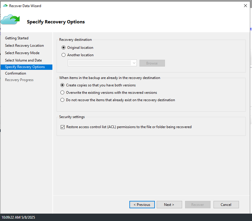

I have 20 TB of backup data in an Azure Backup Vault. This data is from the Microsoft Azure Backup Agent (MARS) from 2 on-premises servers. What is the best way for me to get this data back on premise and be able to recover if needed? Also, could I use an Azure Data box and have the data sent to me and just transfer to a NAS?

    To retrieve and recover 20 TB of backup data from an Azure Backup Vault (using the Microsoft Azure Recovery Services Agent) that was originally backed up from two on-premises servers, your options are limited due to the way MARS manages data. MARS data is encrypted with your passphrase and stored in a proprietary format inside the Recovery Services Vault. You cannot directly export this data using Azure Data Box from the vault — Microsoft does not support this. You must use the MARS agent with the correct passphrase to access and restore the data.
    To work around it, consider the following:
    Step 1: Create a temporary Azure VM
    • Spin up a Windows Server VM in Azure.
    • Install the MARS Agent on the VM.
    • Register the agent using the same Recovery Services Vault and passphrase used originally.
    Step 2: Restore the data to the Azure VM
    • Use MARS to restore the files from Azure Backup Vault to the Azure VM.
    • This converts the encrypted/proprietary backup into regular files on disk.
    Step 3: Copy Restored Data to On-Prem (Options Below)
    Option A: Transfer via network
    • Mount an on-prem NAS share over VPN or ExpressRoute.
    • Use Robocopy, AzCopy, or similar tools to copy the restored files.
    Option B: Use Azure Data Box
    • Order an Azure Data Box (e.g., 100 TB or 40 TB model).
    • Attach it to the Azure VM and copy restored data onto it.
    • Ship the Data Box to your data center.
    • Copy data from the Data Box to your NAS or target servers.
    Step 4: Make the data recoverable on the original servers
    You have two main paths:
    Option 1: Manual recovery from NAS
    • Once the restored files are on a NAS:
      • Access them from the original two servers.
      • Manually move/copy the data back into application-specific locations.
      • This works well for files, folders, SQL DBs (with export/import), etc.
    Option 2: Re-register MARS agent and restore again
    • If needed, you can:
      • Re-register the original on-prem servers with the same Recovery Services Vault and passphrase.
      • Use the MARS agent locally to restore backup data directly from Azure (if you didn’t already purge it).
      • But this method is slow and not ideal for 20 TB unless you're restoring smaller segments.
