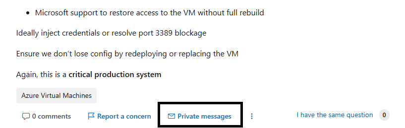

    And as for updating your superiors regarding cause of this blocker, I have shared a detailed RCA with you both in private message and our chat for your ease to update them with data points.
