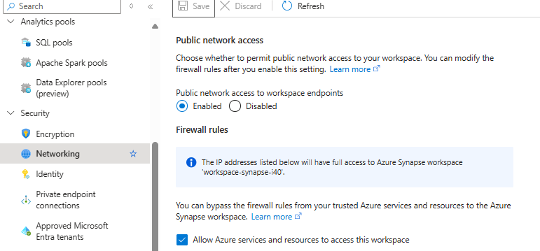

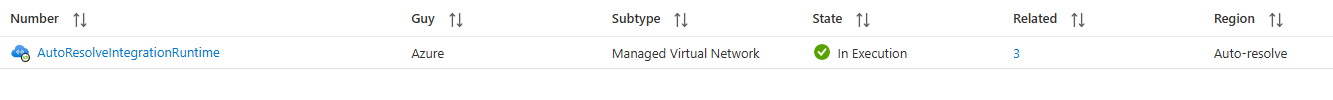

Hello, I am starting with Azure Synapse, and when I want to ingest data with a copy, when I configure the connection to the data source (In this case, it is HTTP with a URL), I get this error, and I don't know why. I have configured the storage account with the IPs that have permissions, and I have also configured the IPs that have access in my Synapse resource. Additionally, I have enabled the managed virtual network with Data exfiltration protection enabled. I believe this should be related to that, but I don't know what extra configuration I need to do to allow this type of connections and others. I haven't found information regarding this error code, I would greatly appreciate any help.

    IP allowlisting won’t apply in this case since the traffic is originating from a managed virtual network using internal Azure infrastructure. Instead, allowlisting the domain is the recommended and supported approach.
