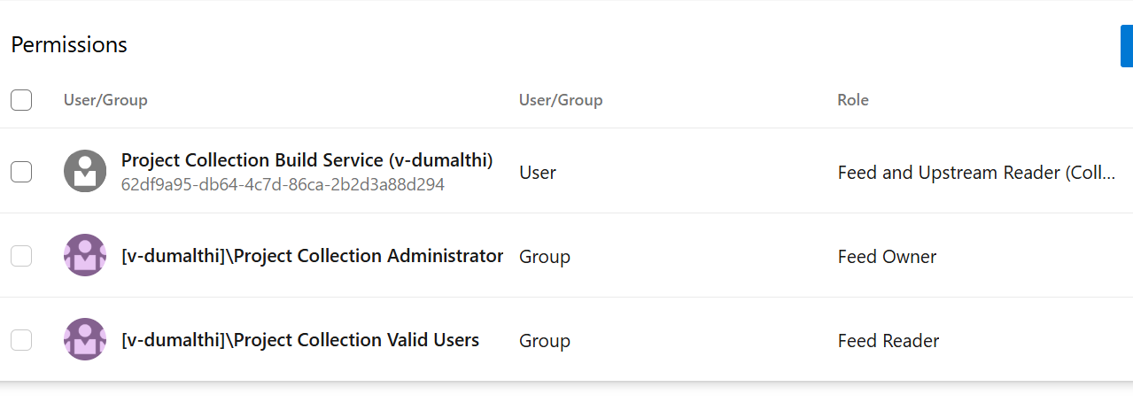

    1. Check Feed Permissions by navigating to Azure DevOps -> Artifacts -> Feed Settings -> Permissions tab -> Ensure you are part of Feed Owner or Administrator roles. User's image
