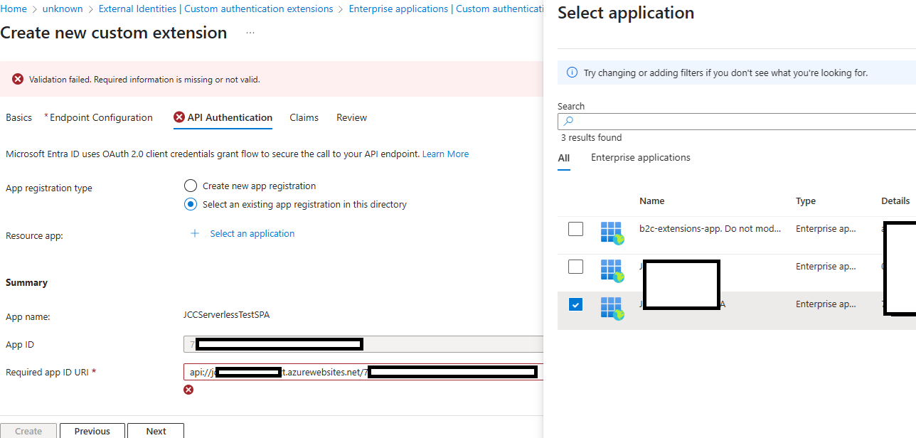

I'm trying to create new custom extension for TokenIssuanceStart but running into error. I'm following this guide:
https://learn.microsoft.com/en-us/entra/identity-platform/custom-extension-tokenissuancestart-setup?tabs=visual-studio%2Cazure-portal&pivots=azure-portal
Specifically YT: https://www.youtube.com/watch?v=_CD3shvqpx4&t=2s
I've downloaded the sample code: https://github.com/microsoft/authentication-events-function
Opened Project in Visual Studio and created and published an Azure Function.
I then went to Entra Admin to create new custom extension but kept getting error like this:
Looking at debug the response error seem to all be "There is a problem with the service.".

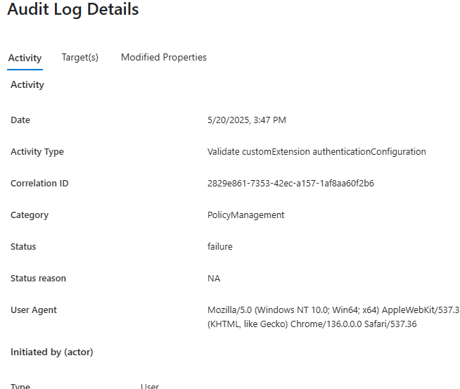

User's image Looking at the Audit log it's failing on this step

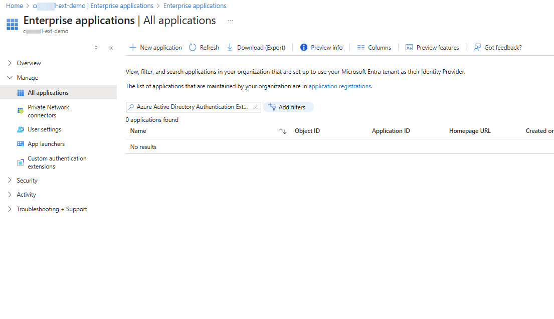

    This typically indicates that the Azure Active Directory Authentication Extensions application is absent in your tenant.
    Steps to Verify and Resolve:
    1. Check for the Application:
    • Navigate to Enterprise Applications > All Applications in the Azure portal.
    • Search for an application named "Azure Active Directory Authentication Extensions".
      • ⁠Or you can use the below PowerShell command to check .  Get-MgServicePrincipal

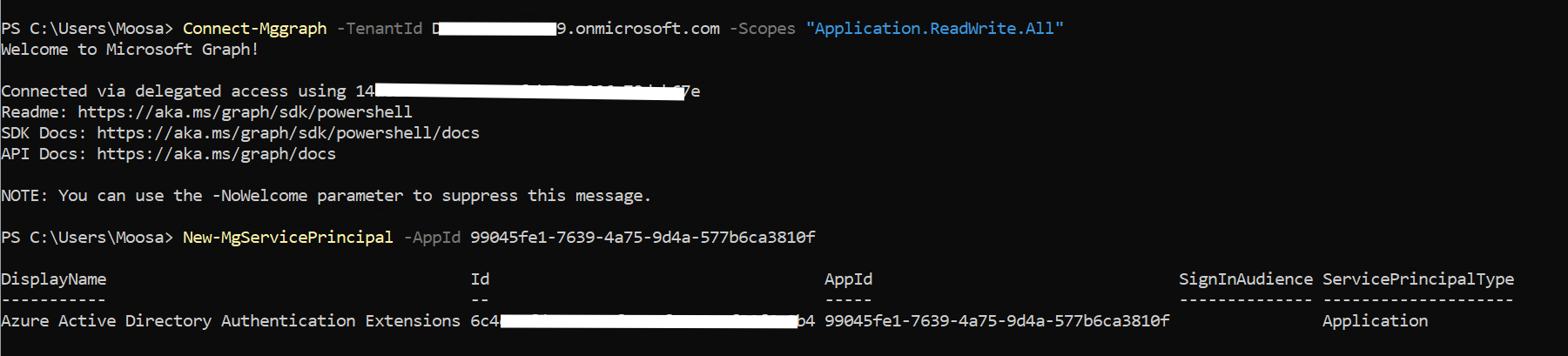

    • Connect to Microsoft Graph and Create the application using below commands-:
        Connect-MgGraph -TenantId <domain>.onmicrosoft.com -Scopes "Application.ReadWrite.All"
        New-MgServicePrincipal -AppId 99045fe1-7639-4a75-9d4a-577b6ca3810f

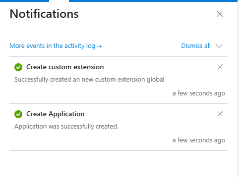

    After completing these steps, attempt to create the custom extension attribute again. This should resolve the issue.
    For reference, here are some screenshots illustrating the process:
    If you continue to experience difficulties, please don't hesitate to contact me for further assistance.

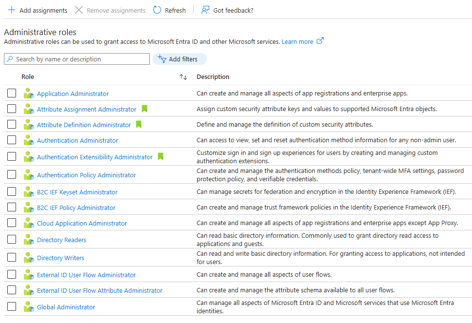

    Thank you for contacting Q&A Forum. Based on your description and process, the issue you’re facing might stem from a few causes including missing permissions, misconfigured Azure Function, or service-side issues. I would suggest you check these following factors:
    • Required role to create custom extensions: to create a custom authentication extension, you are required to have one of the following roles:
    • Global Administrator
    • Cloud Application Administrator
    These roles are required to register applications and configure authentication extensions. For more information, please visit this link: Troubleshoot a custom authentication extension - Microsoft identity platform | Microsoft Learn

    • Check Audit Logs:
    • Microsoft Entra Admin Center > Monitoring > Audit Logs
    • Look for entries under PolicyManagement with the activity "Validate customExtension authenticationConfiguration".
    These logs may show more specific error codes like:
    1003001: Unexpected error calling the custom extension API.
    1003002: Invalid HTTP status code returned.
    1003003: Invalid response body.
