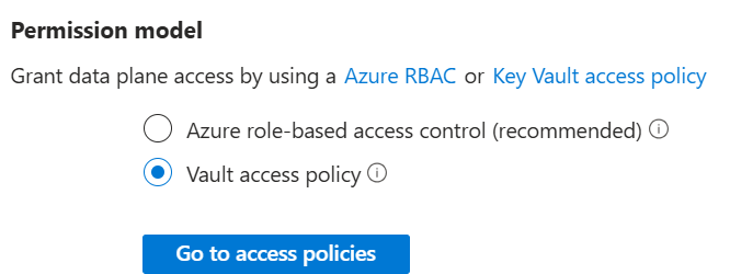

    2. Navigate to KeyVaults -> Your Keyvault -> Access Configuration -> Permission Policy - Select Vault access policy -> Go to Access policies, add the Azure DevOps service principal with Get and List secret permissions. User's image
    3. In Azure DevOps, go to Project Settings > Service connections. Select the service connection you are using for Azure Key Vault. Ensure that the connection is valid and that it uses the correct Service Principal credentials.
    4. Now, navigate to your Azure key vault. -> Access Control (IAM) -> Click add role assignment -> Select Key Vault Secrets User -> Click next -> Select Members -> Look for your Service Principal -> Review + Assign. And then, click Authorize again in DevOps.
