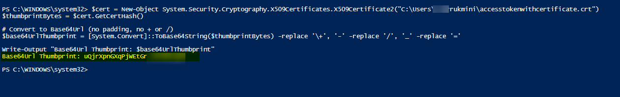

    Generate Base64 Thumbprint:
    $cert = New-Object System.Security.Cryptography.X509Certificates.X509Certificate2("C:\Users\rukmini\accesstokenwithcertificate.crt")
    $thumbprintBytes = $cert.GetCertHash()
    # Convert to Base64Url (no padding, no + or /)
    $base64UrlThumbprint = [System.Convert]::ToBase64String($thumbprintBytes) -replace '\+', '-' -replace '/', '_' -replace '='
    Write-Output "Base64Url Thumbprint: $base64UrlThumbprint"
