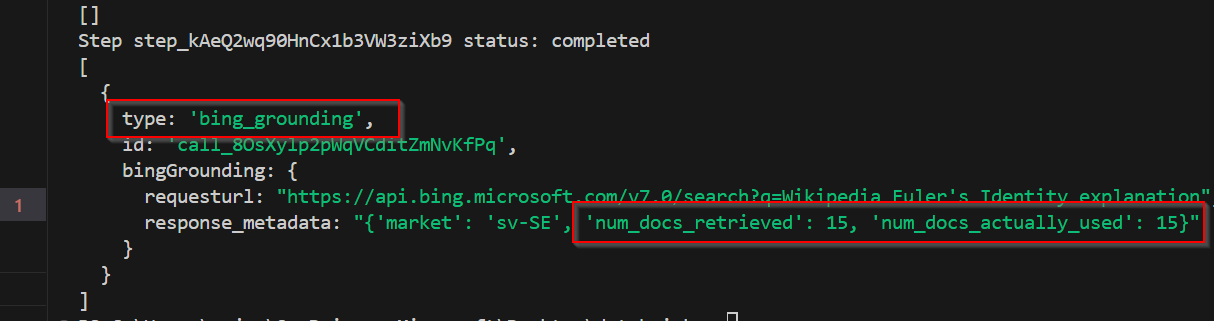

    After you creating the run you can verify it with below code.
      const runSteps = await client.runSteps.list(thread.id, run.id);
      for await (const step of runSteps) {
        console.log(`Step ${step.id} status: ${step.status}`);
        const stepDetails = step.stepDetails ?? {};
        const toolCalls = stepDetails.toolCalls ?? [];
        console.log(toolCalls);
    Output:
    enter image description here
    Try it and let us know if you have any query.
