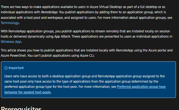

    {A603AEC6-819F-4AB0-BF38-B3E5FADEB0C0}
    https://learn.microsoft.com/en-us/azure/virtual-desktop/publish-applications-stream-remoteapp?tabs=portal

    My recommended workaround would be to stop running the IQMS client from local desktops over mapped network drives. Instead, publish the application inside Azure and let users access it using Remote Desktop or Azure Virtual Desktop (AVD). With Azure Virtual Desktop, you can either provide users with full desktop sessions or stream only the IQMS application interface using RemoteApp. This ensures all application logic and data access happens inside Azure, delivering optimal performance, reliability, and security.
    Microsoft officially supports this approach and provides guidance here: Publish applications with Azure Virtual Desktop (RemoteApp). This method avoids the performance limitations of SMB over WAN and centralizes your workload in a way that is scalable and manageable. Hope this clears your query. Thanks
