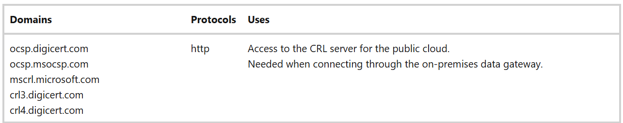

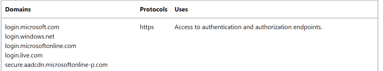

    Certificate Revocation List (CRL) and Authentication Endpoints.
    User's image User's image
