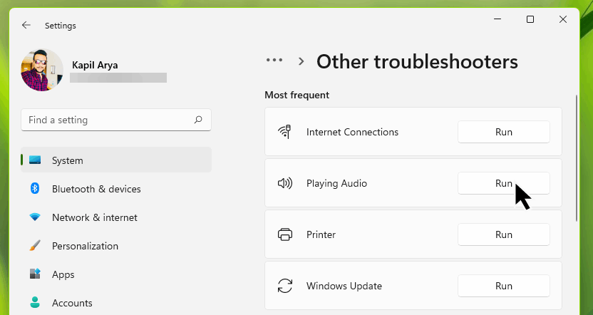

Run Playing Audio troubleshooter
You can treat this tool as first aid solution for the fixing audio problems. This in-built tool can find and fix audio problems automatically.
  1. Open Settings app and go to System.
  2. Under System, go to Troubleshoot > Other troubleshooters.
  3. Click on Run next to Playing Audio troubleshooter.

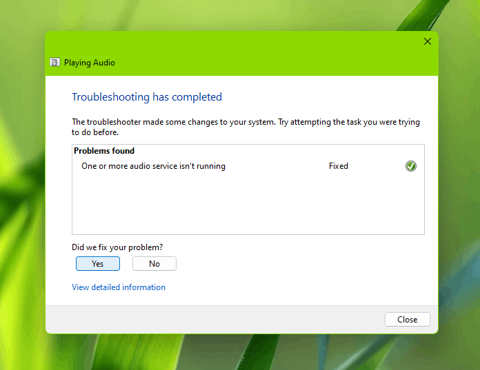

In few moments, you will see that Playing Audio troubleshooter has found some problems and fixed them. If troubleshooter found some issues but can't fix them, continue following other methods mentioned next in this guide.

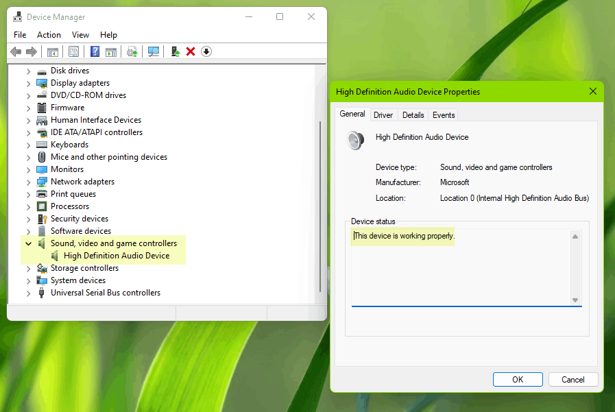

  1. Right click on the Start button or press Windows + X and select Device Manager.
  2. Under Device Manager, expand Sound, video and game controllers or section where audio devices are listed.
  3. Locate your audio device/driver and double click on it.
  4. Verify if the device status is ‘This device is working properly’. If there is some error code with the device/driver, refer this support article to troubleshoot it.

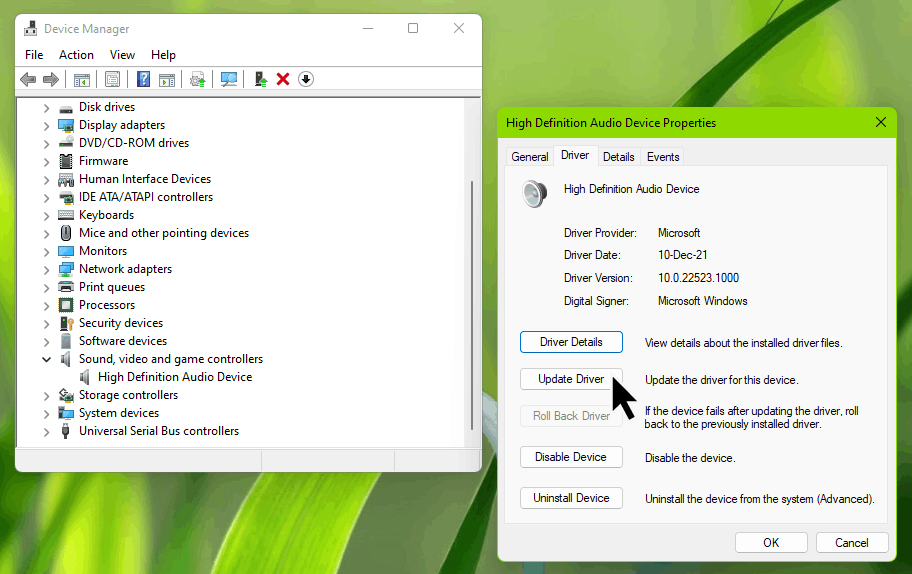

If audio driver is listed and working properly, but still you don’t get your audio issue fixed, next you can try updating your audio driver. Double click on audio driver, go to Driver tab and click Update driver. Follow on-screen instructions to complete the update.
4
If the audio problem you are facing appeared after updating your driver, you can instead use Roll back Driver button to restore audio driver to previous version when it was working fine.

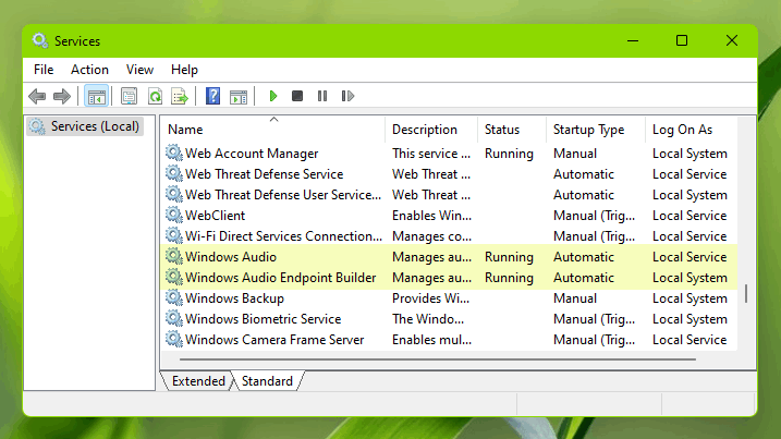

Fix the audio services
If running troubleshooter and making changes to the audio driver was of no help, you can next check for audio background services.
  1. Press Windows + R, type services.msc and click OK.
  2. In Services window, make sure these services are Running and have their Startup type set to Automatic:
  • Windows Audio
  • Windows Audio Endpoint Builder
  • Remote Procedure Call

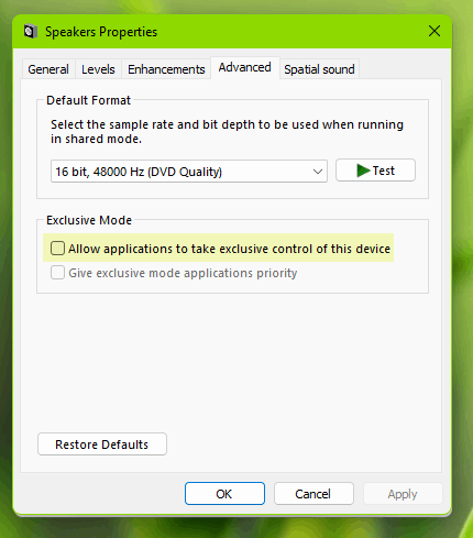

If audio is not working on some specific apps, you go to Advanced tab and uncheck Allow applications to take exclusive control of this device option. Click Apply, OK.
