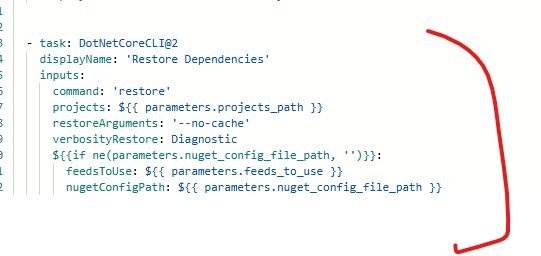

Restore task is failing in the container agent
tarun k 425 Reputation points
2025-06-25T13:33:15.7333333+00:00
I am seeing following error ##[error]Error: The process 'C:\Program Files\dotnet\dotnet.exe' failed with exit code 1

    The errors seem like
    error NU1101: Unable to find package Microsoft.VisualStudio.Web.CodeGeneration.Design.
    error NU1102: Found 100 version(s) in Artifactory [ Nearest version: ... ]
    This usually points to missing or misconfigured NuGet sources.
    If you are using template-based restore (e.g., netcore-nuget-restore.yml)
    Update the DotNetCoreCLI@2 step to explicitly pass the path to the nuget.config, ensuring the path exists inside the container:
    - task: DotNetCoreCLI@2
      displayName: 'Restore Dependencies'
      inputs:
        command: 'restore'
        projects: '**/*.csproj'
        restoreArguments: '--no-cache --configfile $(Build.SourcesDirectory)/nuget.config'
