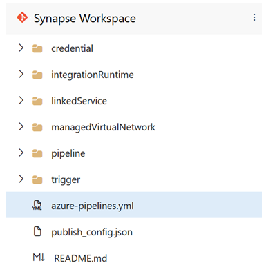

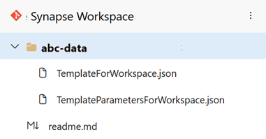

For reference this is my Azure Repos structure:
main branch:
workspace_publish branch:

  2. Cataster 681 Reputation points
    2025-06-26T14:06:24.1966667+00:00
    @Durga Reshma Malthi Thanks for your suggestions, however, they didnt resolve the error unfortunately. I dont even know if the problem is with the template paths json files, the error is ambiguous it doesnt really say much...
    Also Im not using different repositories. Please refer to the screenshots to see how my repo is setup with the two branches. And I already had used checkout: self in the yaml filei provided

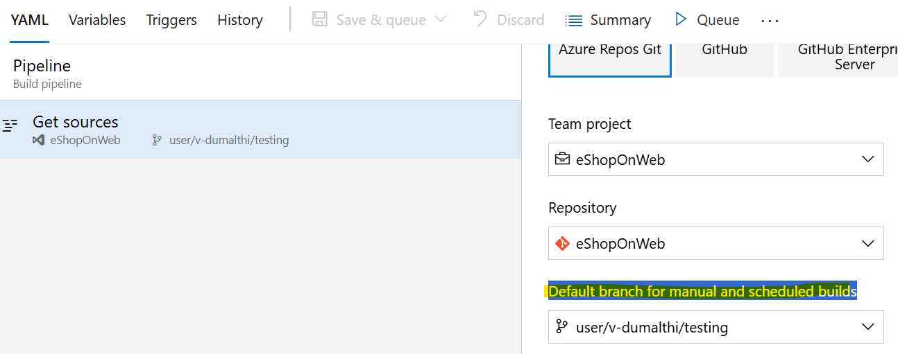

    Even though the workspace_publish branch triggers the pipeline, make sure your default YAML path and the pipeline definition point to that branch as well, Go to Pipelines -> Your Pipeline -> Edit -> Triggers -> YAML Tab.

  4. Cataster 681 Reputation points
    2025-06-26T14:34:12.35+00:00
    @Durga Reshma Malthi Thanks i already tried $(System.DefaultWorkingDirectory)/ in my first question but didnt work
    TemplateFile: '$(System.DefaultWorkingDirectory)/abc-data/TemplateForWorkspace.json'ParametersFile: '$(System.DefaultWorkingDirectory)/abc-data/TemplateParametersForWorkspace.json'
    Anyways I tried your second suggestion Even though the workspace_publish branch triggers the pipeline, make sure your default YAML path and the pipeline definition point to that branch as well, Go to Pipelines -> Your Pipeline -> Edit -> Triggers -> YAML Tab.
    The Default branch for manual and scheduled builds was set to main. so I changed it to workspace_publish and tried queuing afterwards but then i got this error:
    Encountered error(s): Could not find valid pipeline YAML file for this branch/tag
    This makes sense i suppose considering that the azure-pipelines.yml is in main not workspace_publish. On the other hand, my Template/Parameter files are in workspace_publish...please refer to my screenshots from the question to see how the repository and branches are setup currently.
