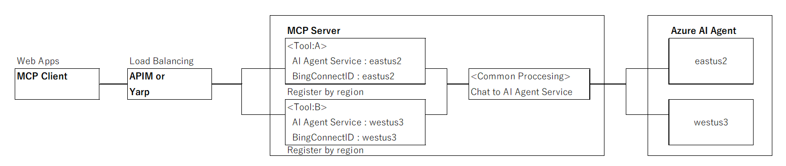

I am creating a Blazor server app for a chatbot using the Azure AI Foundry Agent Service.
With the conventional AOAI (Azure OpenAI) API alone, I was able to load balance API requests using services like Azure API Management or YARP. However, with the new Agent Service, the Agent itself calls other tools (for example, BingGroundingSearch). The connection information for that tool needs to be determined at the time of the Agent's instantiation, which makes load balancing difficult.
How should I design the architecture?

    At that time, the BingGroundingSearch connection ID to connect to is: /subscriptions/<subscription id>/resourceGroups/<rg name>/providers/Microsoft.CognitiveServices/accounts/<eastus2 region's AI agent name>/projects/<project name>/connections/bingopenai Even if eastus2 is load balanced and connected to westus3, the BingGroundingSearch connection ID remains that of the original region, eastus2.
    Yes*, Respective sources stay in native region during load balances. Only requests get routed to different endpoints through APIM (Tested and Enterprise ready)/ Loadbalancer*

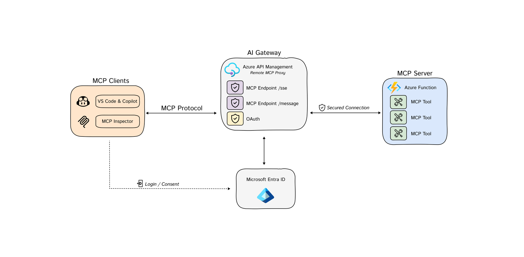

    I had suggested MCP Protocol as viable solution as multiple MCP server can be load balanced through APIM or load balancer
    Went through below documentation.
    https://techcommunity.microsoft.com/blog/integrationsonazureblog/azure-api-management-your-auth-gateway-for-mcp-servers/4402690
    Idea mentioned in above doc requests are routed the from AI agent or copilot with MCP protocol to APIM Gateway which will route the requests to multiple MCP server connected with "Grounding with Bing search" services and the processed information gets back to AI agents or copilots eventually.
    You can connect to APIM or load balancer with Logic app or Azure function
