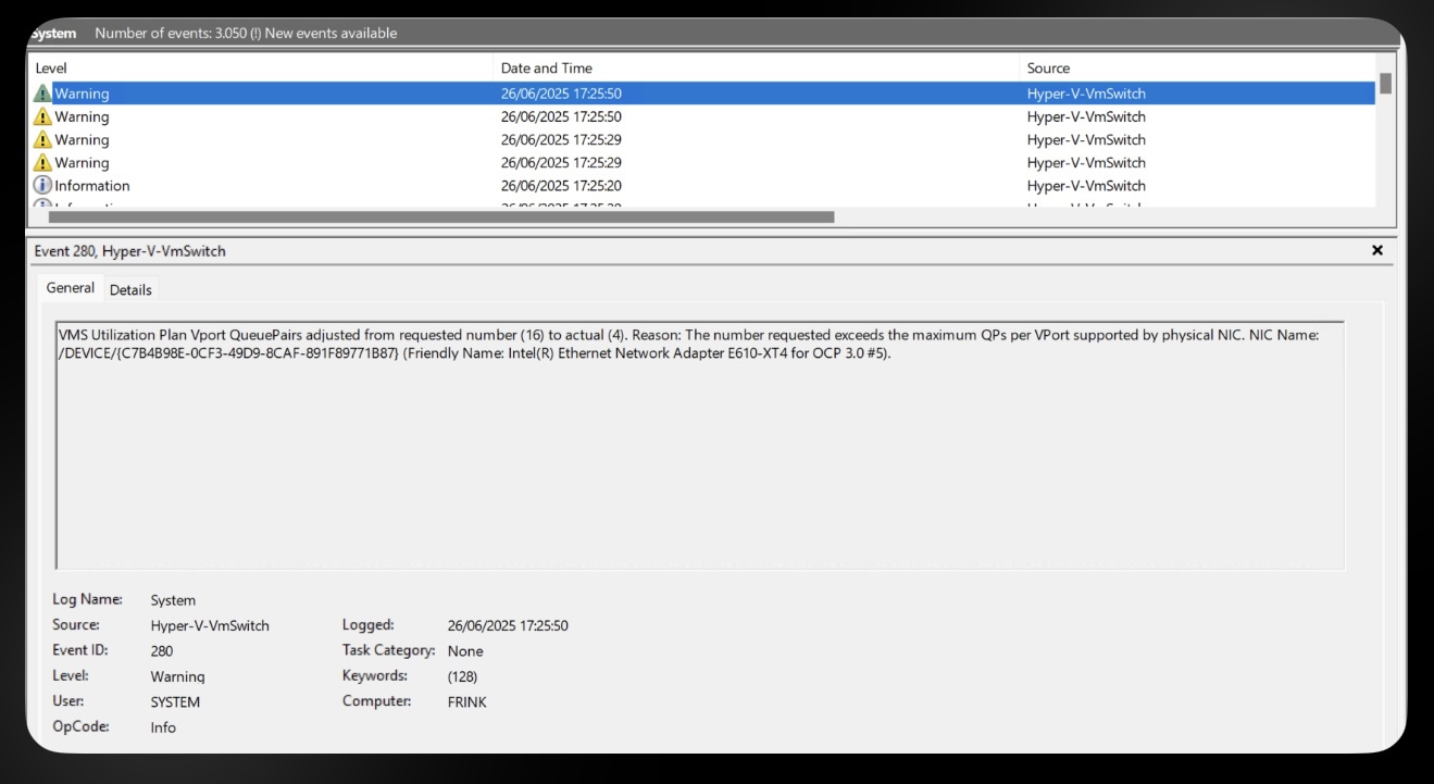

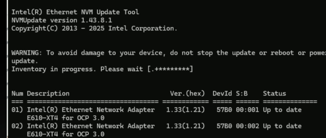

We’re facing a consistent issue on a Windows Server 2025 host using Hyper-V with Switch Embedded Teaming (SET) and Intel E610-XT4 for OCP 3.0 NICs (8 total). Firmware is NVM 1.33 (1.21), and the driver is from Intel Ethernet Adapter Complete Driver Pack 30.1.1.
Problem:
As soon as VMs are created, Event ID 280 appears in the Hyper-V-VmSwitch log:
“VMS Utilization Plan Vport QueuePairs adjusted from requested number (16) to actual (4).
The number requested exceeds the maximum QPs per VPort supported by physical NIC.”
This occurs regardless of VM count or host load. The E610-XT4 cards report:
  • VMQ enabled
  • 16 RSS queues
  • SR-IOV supported (62 VFs)
But Hyper-V always limits IOVQueuePairs to 4 per vPort, unless we force it to a lower value.
We also see Event ID 285 frequently:
“V-Switch operation OID_GEN_STATISTICS took too long to complete. Operation Type: OID HOST VNIC.”

    I am also seeing same error and VM's fail to Live migrate and backup peformance issues which also might be related. This is on Windows Server 2025 Hyper-V Failover Cluster using Broadcom NetExreme cards. Do you see Event ID 280 in System log?
    VMS Utilization Plan Vport QueuePairs adjusted from requested number (16) to actual (8). Reason: The number requested exceeds the maximum QPs per VPort supported by physical NIC. NIC Name: /DEVICE/{B38906E1-48A8-4E93-BB3B-BE02F7F29B21} (Friendly Name: Broadcom NetXtreme-E P425D BCM57504 4x25G SFP28 PCIE Ethernet #3).

    Yes, we have already updated both the driver and firmware to the latest versions from Intel’s official Ethernet Adapter Complete Driver Pack 30.1.1. The current NVM firmware is version 1.33 (1.21), and all 8 E610-XT4 adapters are reporting VMQ and RSS correctly.
