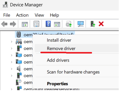

    1. Please note the published name here is "oem46.inf"

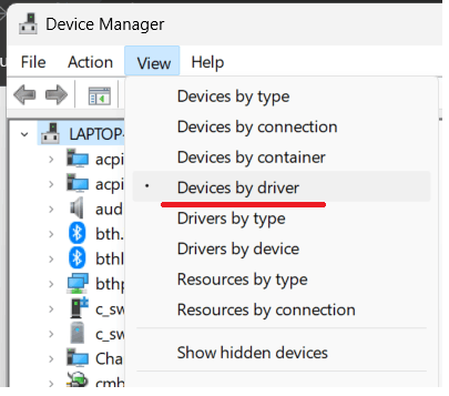

    2. Select the Start button and type “Device Manager" and follow as shown below.
    1. Select the right driver from Device manager"oem46.inf" and right click and select remove driver.
    Example :-
    7. System needs to be restarted after removal of the driver.
    Hopefully this will solve your issues no need to install any software for this.
