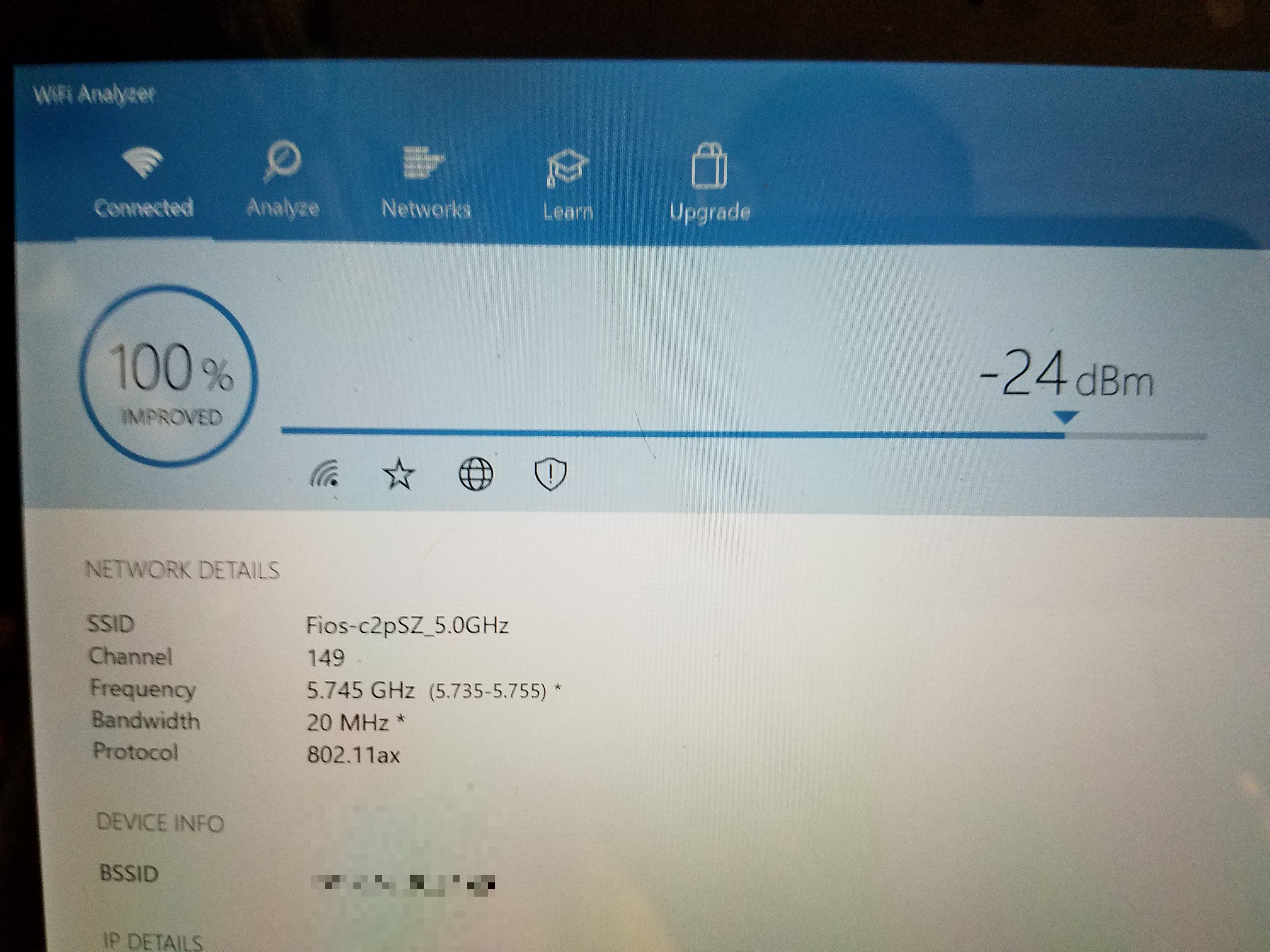

Lo and behold...the app showed a glaring difference between the two units. The Surface Laptop 1 registered a -24 dbm. The Surface Pro 7 registered a -30 dbm. The SP7 reading wavered so to the point where I could see that the signal strength meter dropped one bar when the signal strength fell to -34 dbm.

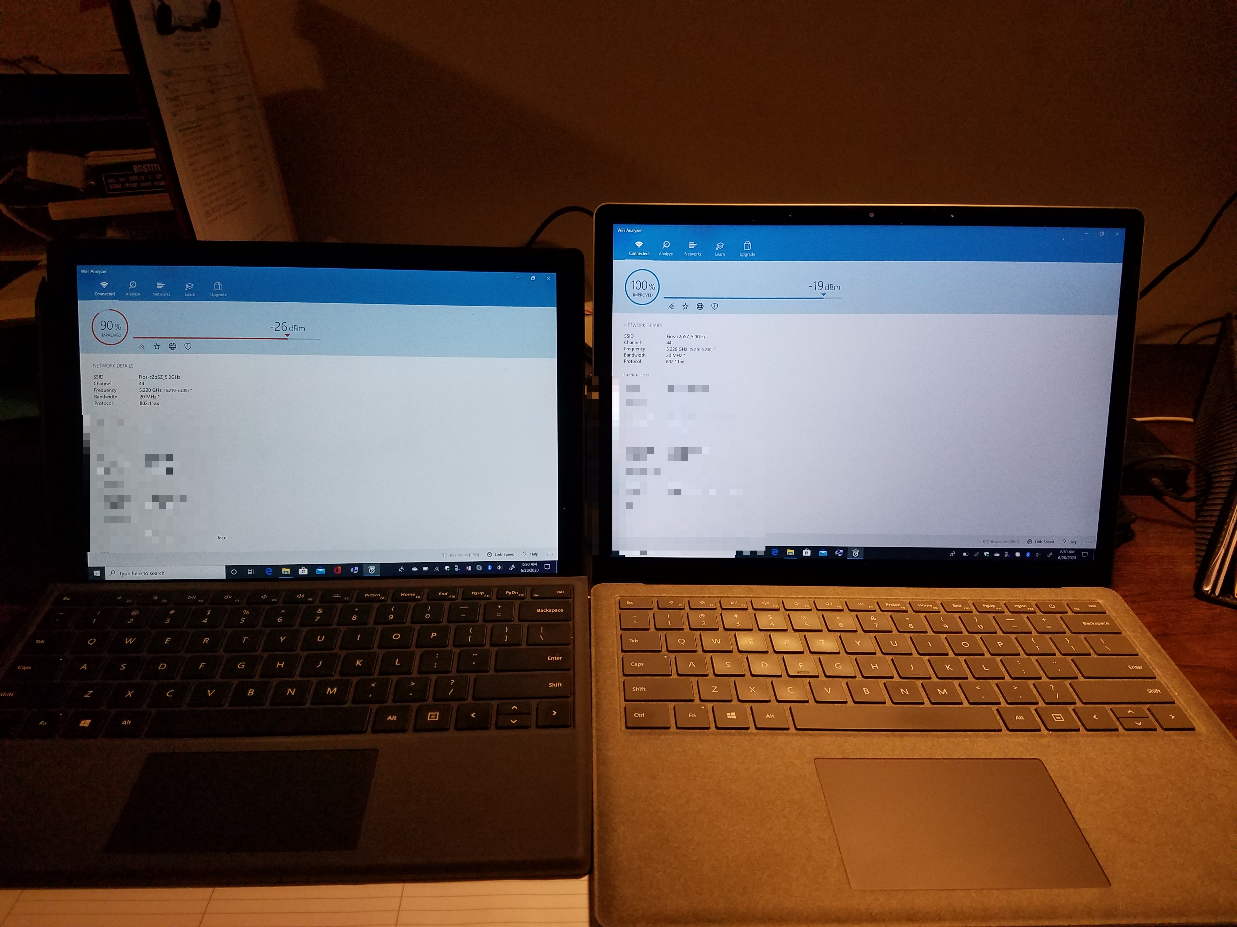

    Here are my two Surface devices. The SP7 is on the left and my SL1 is on the right. The extender is just off camera to the right.
    Here is a picture of what the SP7 sees for a signal from the extender...

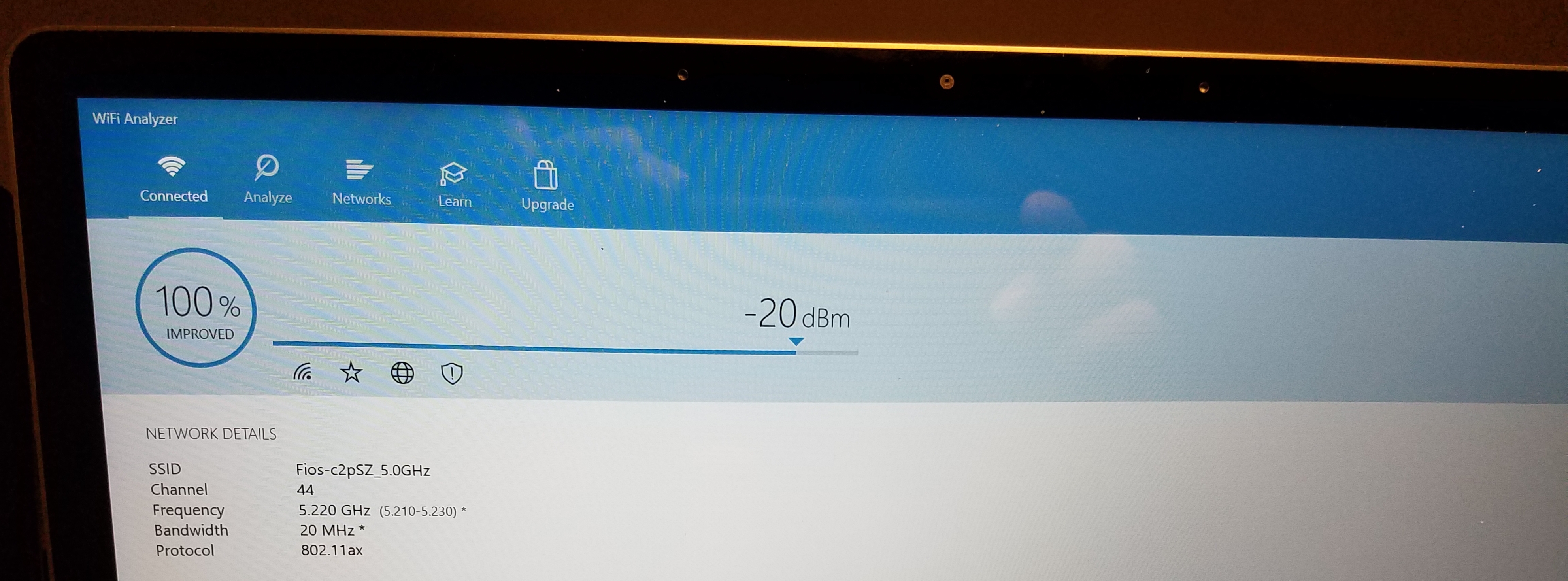

    Now here is what the SL1 sees from the extender...
    9db difference connecting to the same device located two feet away...

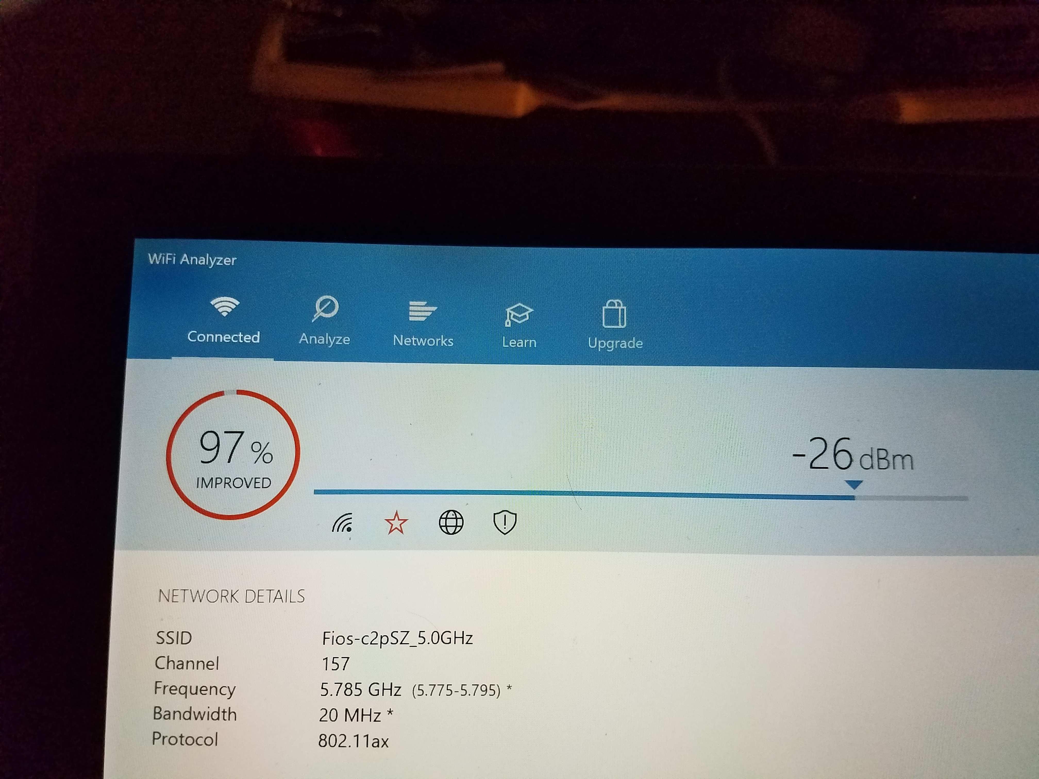

    I brought the SP7 back up to the bedroom and powered up the extender. This is what I see....
    The extender has switched to a different channel. The SP7 seems happy with this one as well. The reading is shifting around, but, has not fallen below -31 dBm. The signal strength meter is fully illuminated.
    So the question now becomes...Does the Intel radio have weaknesses with some of the channels associated with the 5 GHz frequency? Remember that the SL1 had saw a robust signal on channel 44 while the SP7 was indicating a more marginal signal with that same channel.
