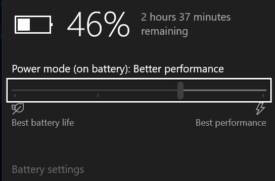

If you are facing high battery utilization drainage, disable the above Simultaneous Multithreading (SMT).

9)Once the unit is fully charged at 100% switch back and forth between Best & Better performance and see the difference.

Before Disabling SMT with all up2date drivers and updates via 1903 build. 18362.387
After while having SMT disabled..
