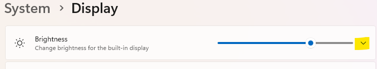

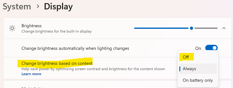

    1. Select the Start button, then select SettingsSystemDisplay.
    2. In Display settings, select Brightness, and then for Change brightness based on content, select Off.
