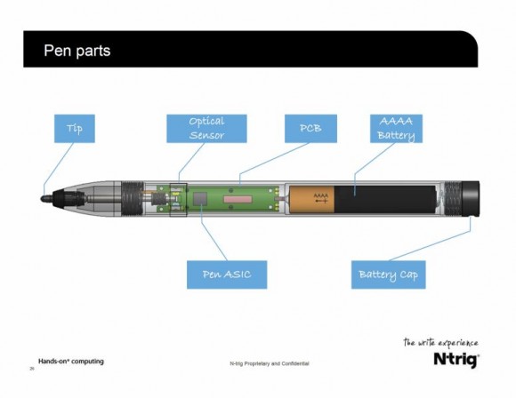

    The pen is made by N-Trig
    You can find a lot of info about it here (it's Spanish so you may need some help of Google translator)
    http://wintablet.info/2014/05/n-trig-duosense2-como-funciona/    (Spanish)
    It's not clear which battery will be used for BT. The available information talks about just one battery and the second battery was added for the SP3 I believe.
    http://www.n-trig.com/Content.aspx?Page=DuoSenseActivePen  (English)
