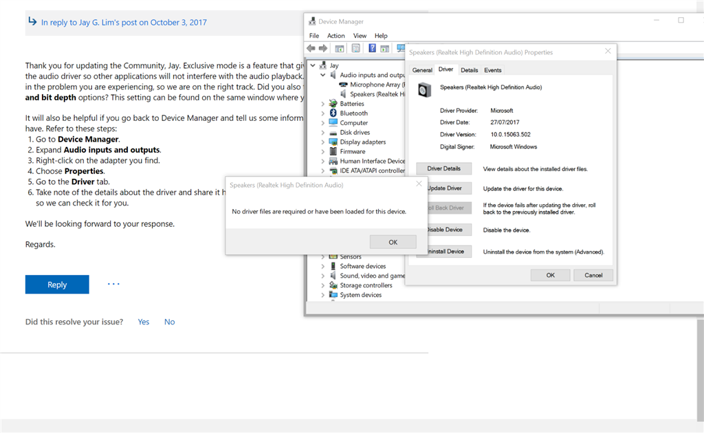

    2017-10-05T07:37:11+00:00
    Dear Ruz
    Thank you very much for your reply. Following your instructions, I was unfortunately unable to load the driver's detail.
    The screenshot I am attaching below was all I could get.
    I really appreciate your help
    Kind regards,
    Jay
  5. Anonymous
    2017-10-07T00:04:57+00:00
    We appreciate the information. Looking at the screenshot you shared, you seem to have Microphone Array on your Surface Pro 3. Is this something you installed by yourself or did it come integrated with the device?
