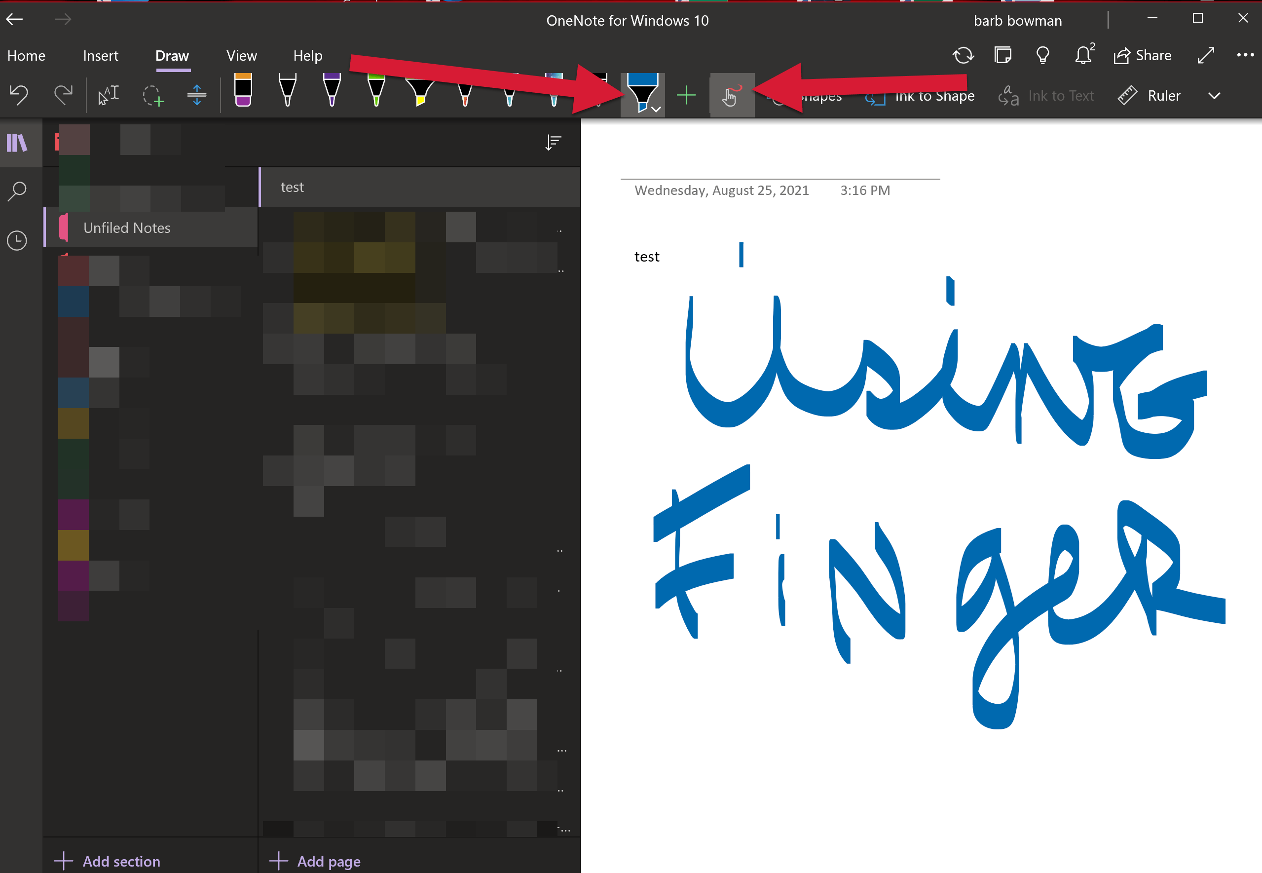

  3. Barb Bowman 80,795 Reputation points MVP Volunteer Moderator
    2021-08-25T19:39:26+00:00
    If you select the Draw menu, then pick a pen and then select the icon to draw with finger as shown below and can't make this work, then I don't think the pen is the problem.
    Let's try reinstalling some drivers:
    1. Select the search box in the taskbar, type
    device manager
    and then select Device Manager
    1. Click the arrow to the left of Human Interface Devices to expand.
    2. Right-click HID-compliant touch screen, and then select Uninstall. If there are 2, uninstall both. Don't delete if prompted.
    3. Then uninstall the Intel® Precise Touch Driver (don not delete if prompted)
    4. Restart
    Does the pen work now/can you draw with your finger?
