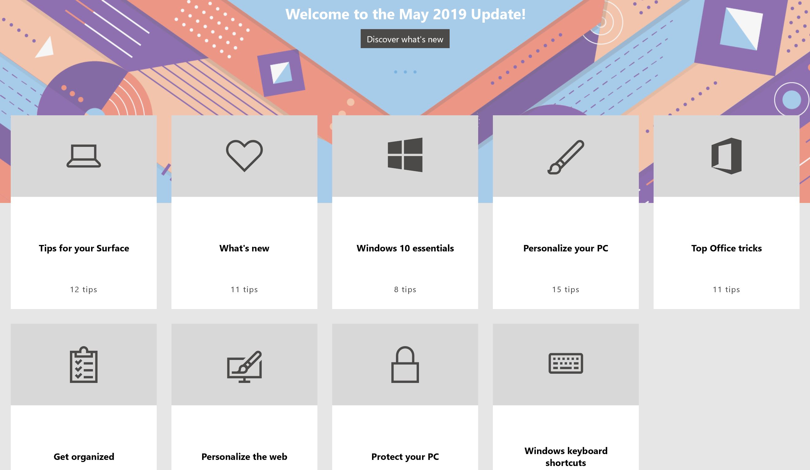

    2019-08-16T04:59:53+00:00
    This was the big update received. Everything was fine before this update. But received this update after few weeks received one more update in July-August. That update created the cause of Battery draining.
