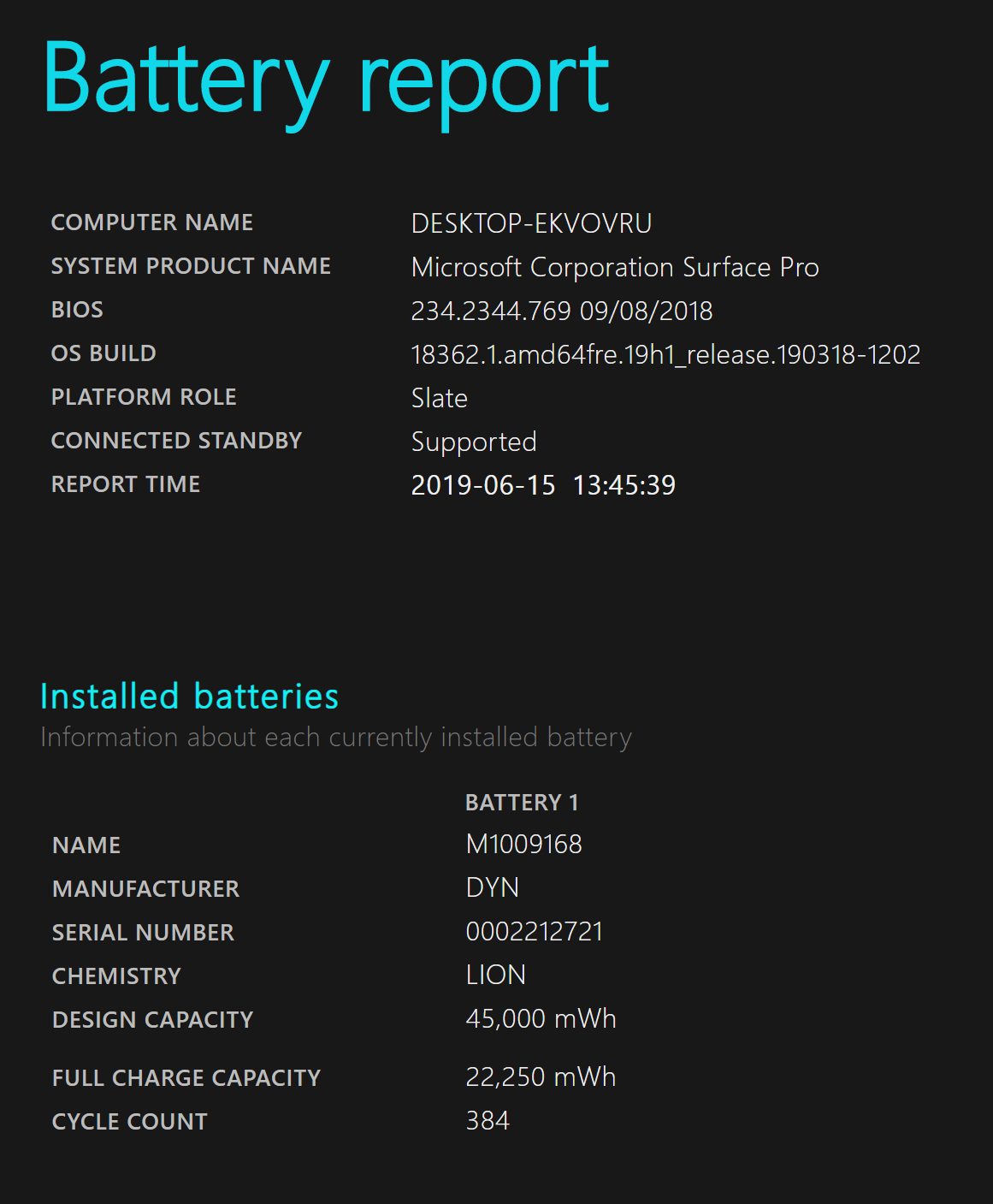

Hello,
I just wonder if some of you who own this version of Surface Pro have the same issues like mine as in below:
ISSUE: Battery at full charge drastically degraded and swingsConditions observed lately:-The battery runs out within 1-2 hrs just by browsing websites/Youtube (tested on both Chrome&M. Edge)
-To fully Charge, takes only around 20-30mins (Est. full charge not accurate)
-Battery sometimes drops by a ridiculous amount E.G. by 20-30% in 1 sec.After checked with Battert Report run in CMDAt Designed Cap at : 45,000,
My Full Charge history as below (Noted that i tried to reset the windows and all previous history is gone so this is what i remember)
First bought (Jan,2018)
Full Charge 2018                                 : around 40,000 0 44,000
Full Charge 2019(Early months)          : Starting to drop to 35,000
Full Chrage as of the last few months : 25,000
Full charge as the last few days of notice: Swings from 22,000 to 9,000 life cycles at 383
Now i cant use it outside without charger. This is very frustating while working**.**
As my device is out of warranty, after searching online, the onl way is replacement at 500USD which seems ridiculus to me just because of battery. I bought this expensive device for the reason of long-term use. this is just a year and a half. Shouldn't it last for 4-5 years for its price?
If you have the same issues and any solutions/suggestions, feel free to share and discuss.

  3. Barb Bowman 80,690 Reputation points MVP Volunteer Moderator
    2019-06-15T09:40:55+00:00
    I'd try two things. Otherwise it would appear to be a failing battery. First,
    try to recalibrate the battery - good tutorial at
    https://www.windowscentral.com/how-calibrate-battery-your-windows-10-laptop
    Based on your description and the report, I don't think recalibrating will work
    but you should try it. Also try reinstalling the battery drivers:

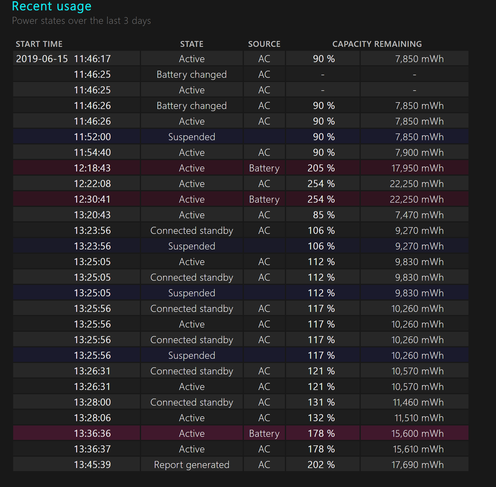

    2019-06-15T07:12:00+00:00
    Screenshots of my Battery Report: (Not fully charge as of now, but it seems full at 22,xxx.
    A few days ago it was at 9,000. (seems to swing from 22.000 to 9,000
  5. Barb Bowman 80,690 Reputation points MVP Volunteer Moderator
    2019-06-15T11:05:10+00:00
    I think my battery capacity has been degraded.
    sadly, yes..
