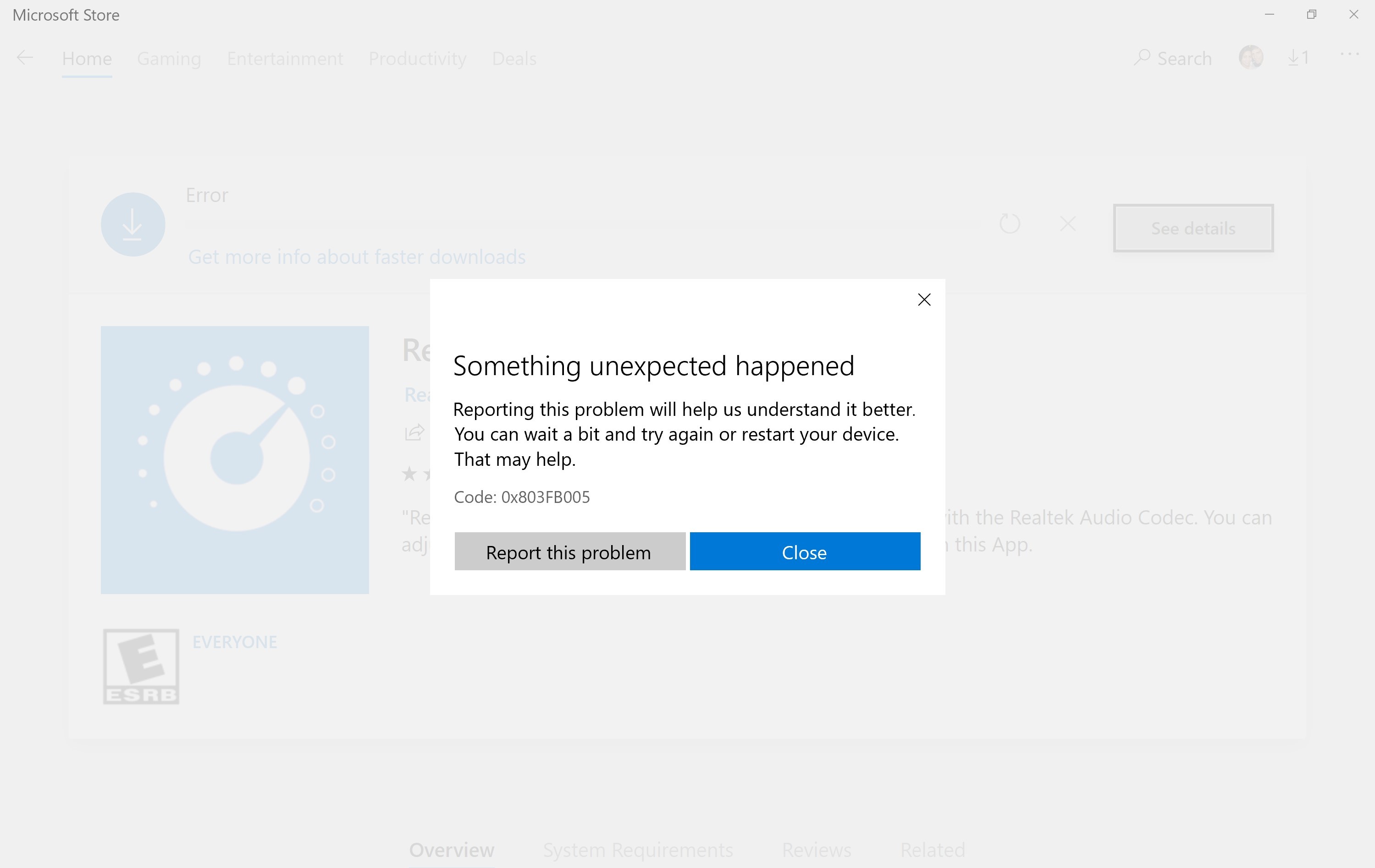

    I've also tried to install RealTek audio Control about 20 times, and each time it gives me this error from Microsoft Store:
