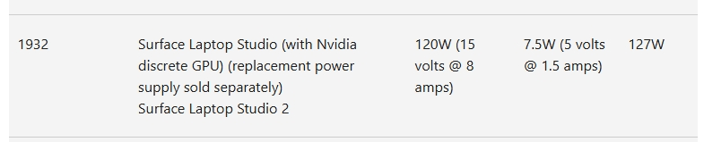

    I noticed that the charging capabilities of the computer is rated at 120 watts (15 volts by 8 amps). However, these powerbanks are only capable of 5 amps maximum. Could this be the issue?

    The Surace is rated at 120W(15Vx8A), but since the Powerbank you're using only supports a maximum of 5A, meaning that to meet the Surface's rating, your Powerbank will need to support a 24Vx5A charging protocol. However, from the end result, it appears that none of the Powerbanks you are using support this protocol.

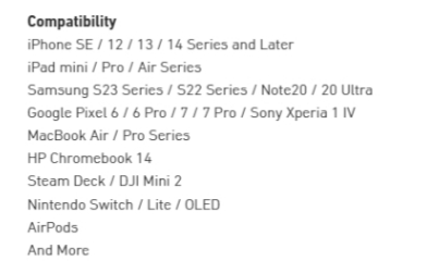

    In addition, in the official Powerbank link, you can see the compatibility list for this Powerbank:
    While they list a number of devices here, they don't specifically list Surface devices.
    Therefore, I still think this issue is related to the Powerbank you are using, and you still need to contact their customer support and confirm some information:
    1. Does this Powerbank provides 24Vx5A charging protocol.
    2. Whether this Powerbank is compatible to charge the Surface Laptop Studio 2.
