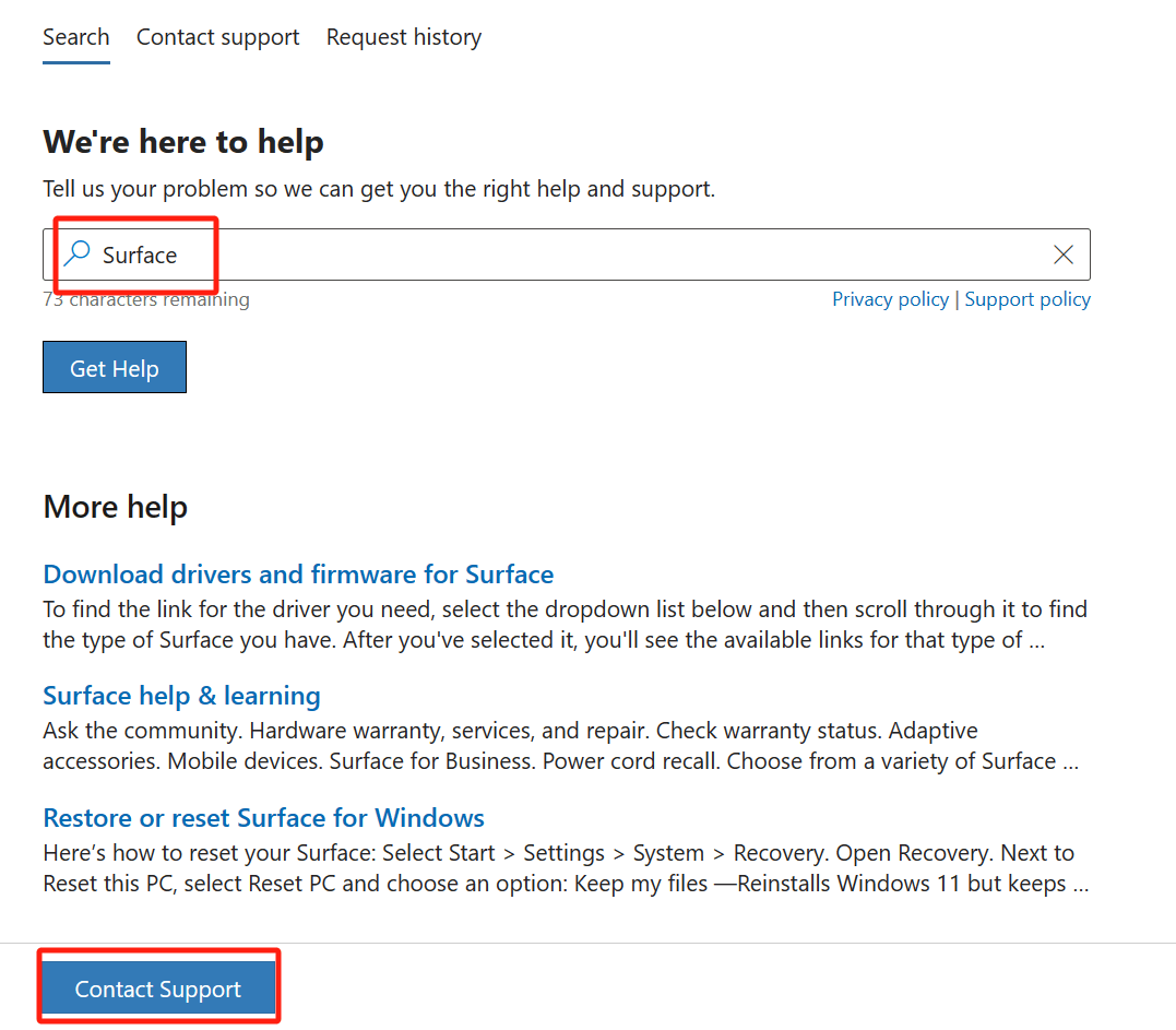

    1. Type Surface, press Enter, and click "Contact Support" at the bottom:

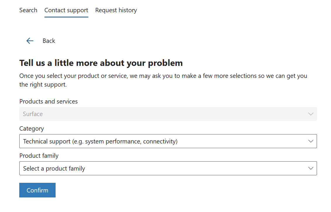

    1. Select Technical Support and select the device model you are currently using in Produce family, then click Confirm:

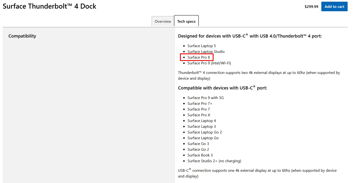

    Just to clarify, the Surface Thunderbolt™ 4 Dock normally supports the Surface Pro 8:
    However, in your tests, the same problem occurred on the Surface Pro 8, so it is clear that the Ethernet port on the Surface Thunderbolt™ 4 Dock you are using may be faulty and need to be repaired.
    You can refer to the guidance process I provided you earlier, contact Surface Live Support, and send the Surface Thunderbolt™ 4 dock to the Surface Technical support team for inspection or repair.
