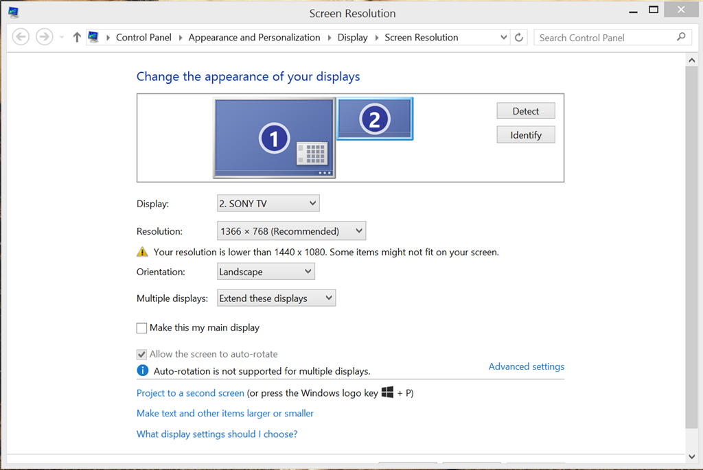

My Surface Pro 3 is fully updated with the latest firmware and updates and the wireless display also has the latest updates.

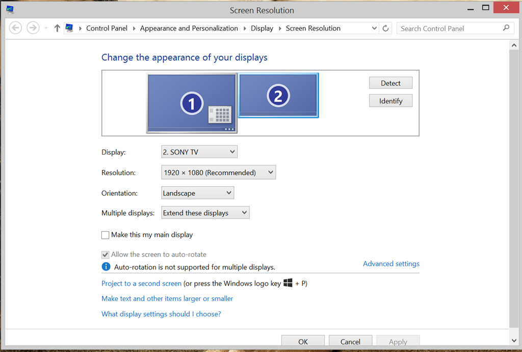

When I have my bluetooth on and I connect to the wireless display adapter, my TV's max resolution that I can set is 1366 x 768 but when I turn my bluetooth off first and then connect to the wireless display adapter I can set my TV to 1920 x 1080.
It's kind of annoying to have to turn bluetooth off first before I connect to my tv. Is there something I can do to fix this issue?

    This is happening to me as well.  However, I only have the Arc Touch Mouse for Surface and the Surface Pen connected via bluetooth.  If Bluetooth is on, I get the 1366x768 resolution.  If Bluetooth is off, I get 1920x1080.  If I turn off bluetooth, connect at the 1920x1080, and then enable bluetooth, it changes resolution back to 1366x768.

    2015-01-25T04:05:19+00:00
    It's a Sony KDL-40EX700, I'm setting the resolution in the windows control panel...
    The Bluetooth devices that I have paired and connected are the pen, the arc touch mouse surface edition and my xperia z3 compact phone.
    After I turn off the Bluetooth and then connect to the display adapter I get the option to increase the resolution...
    I can turn the Bluetooth back on right after I connect and everything seems to still work fine.
