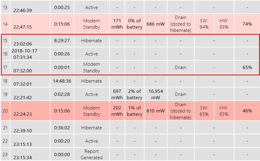

    I have picked out one area on the report which might demonstrate the situation.
    As indicated on the graph, the system was in hibernation so no line should have been drawn.  I can only guess, when the system was active again, it saw the battery drain and was confused so it drew the line.
    After the line the system went back into hibernation, where it burned 19% of the battery and no line was drawn.
    Does your system get warm anywhere on the device during the hibernation periods?
