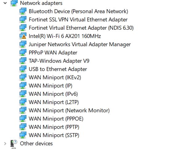

Fig. 1 Snip taken from my device manager
Note: As seen, I believe the root of my Wifi Woes are from my Intel(R) Wi-Fi6 AX201 wifi chip
Haven't been able to solve that one via uninstalling and reinstalling the wifi card driver, updating it to the latest version or simply restarting my laptop.

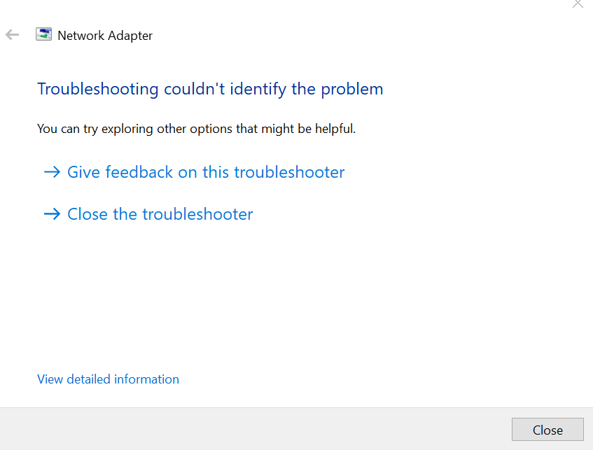

Fig. 2 A snip of troubleshooter having no clue what any issues on the network adapter might be.

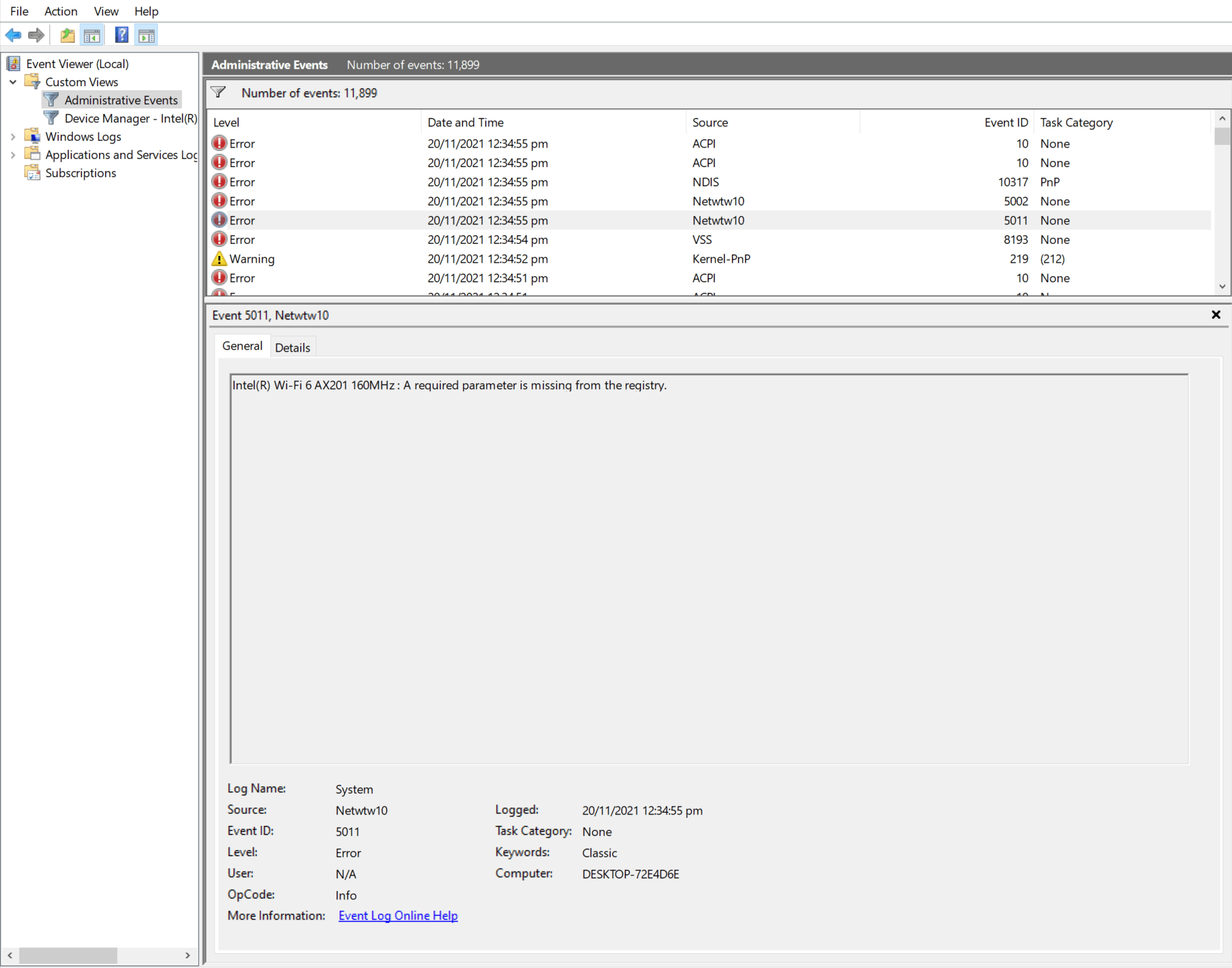

Fig.5 Went into events viewer to figure out where things went wrong. I can't really make out what the error are trying to say so I left it here. Hopefully someone can tell me more about this. And what I can do to fix this.

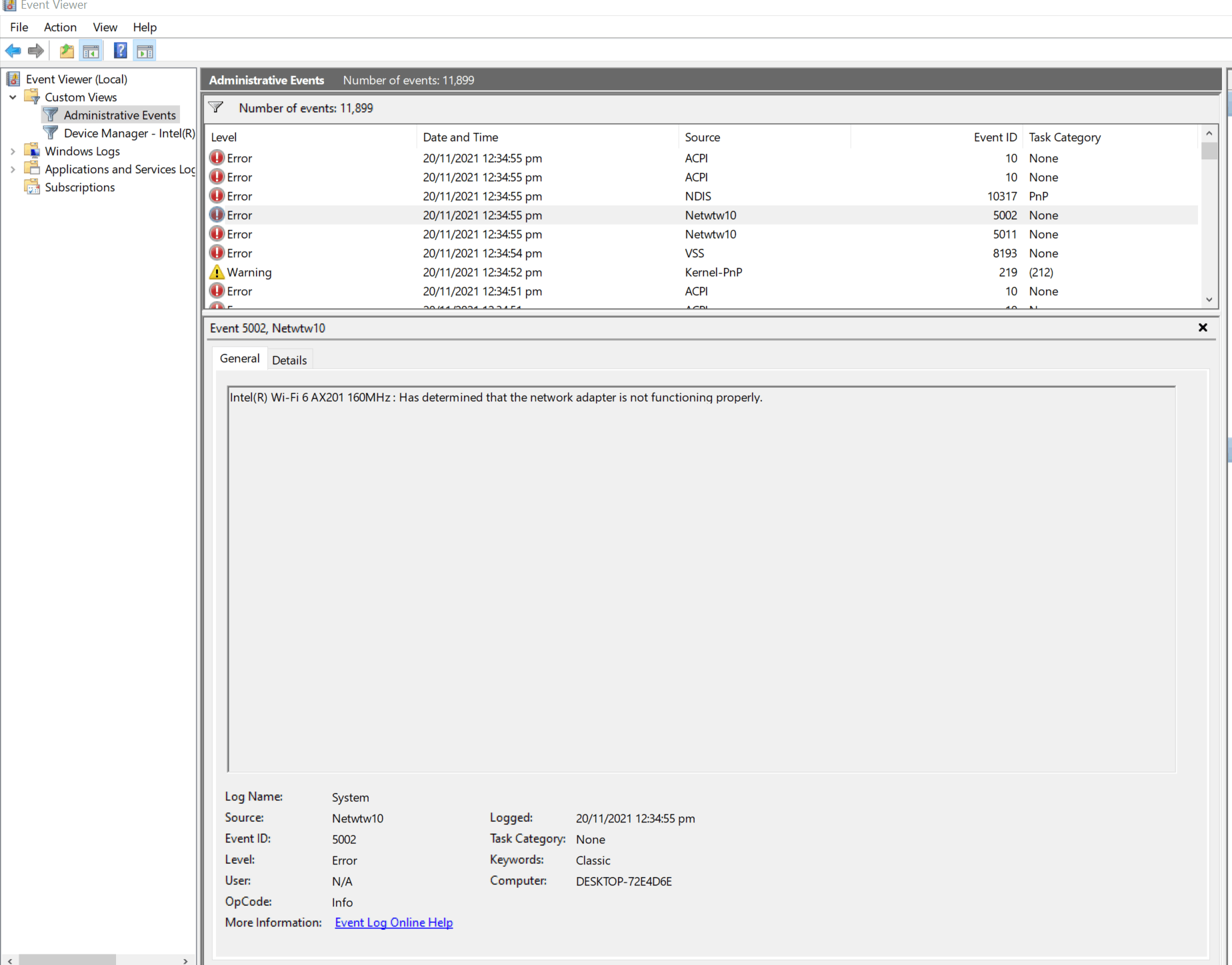

Fig.6 Error message in event viewer that is most likely a direct result of the error in Fig.5

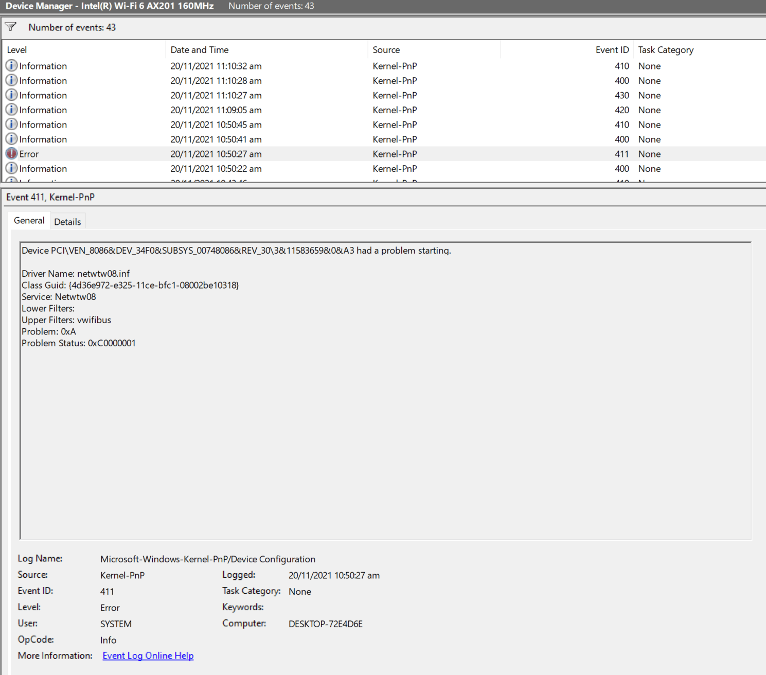

Fig.7 An Error in the event viewer that would probably be linked to the mystery of the WiFi Woes of my Surface Laptop. I just hope this doesn't mean that there's a hardware issue with my Wifi card...

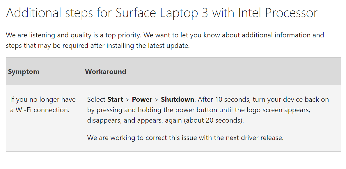

    Edit 12.22.21 - Microsoft has now acknowledged an issue:
    Surface Laptop 3 update history (microsoft.com)
    30+ people found this answer helpful.
    2021-12-01T14:14:51+00:00
    I found that the device wont start, I tried a few things to get that to happen, airplane mode on/off, reset network adapter/reset computer...
    Also uninstalled drivers, remove device settings and reinstall driver 22.90.0 which seems to be stable.
    So, after al that, I held down the power button continuously until and after the screen prompted me to slide down to turn off.
    Continue to hold the button down until the windows icon appears and the loading halo is rotating and then release.
    Do the hokey pokey
    and resume using the internet.
    I assume its a power management issue and a later update will resolve it.
    20+ people found this answer helpful.
