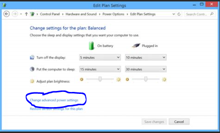

    • Hover your mouse pointer over the battery icon and right click. Select Power Options. Choose Change when the computer sleeps. Tap on Change advanced power settings. Select Sleep and under Sleep, tap on Hibernate after. Change it to Never, both On Battery and Plugged In. Select Ok and then Apply.
    Just a heads up, if this won't work, kindly contact Microsoft Surface Support for further resolution.
    Please let us know of the outcome.
