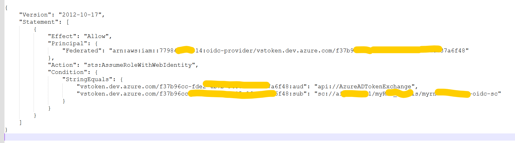

Sent the yaml as well, trust relationship policy which i have setup at aws end

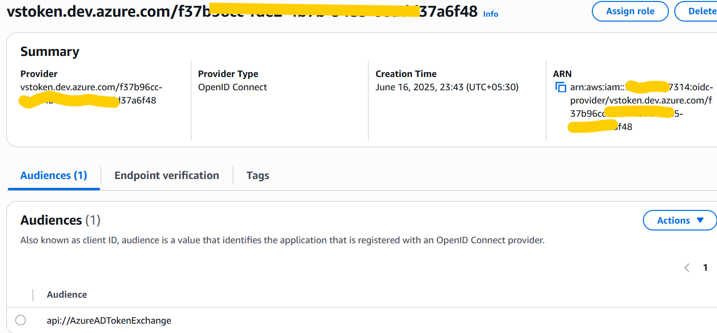

i am using service connection to make the connectivity with AWS and the approach i am following is using IAM Role and OIDC , for which i created Identity provider and uses the identity provide while creating IAM Role.

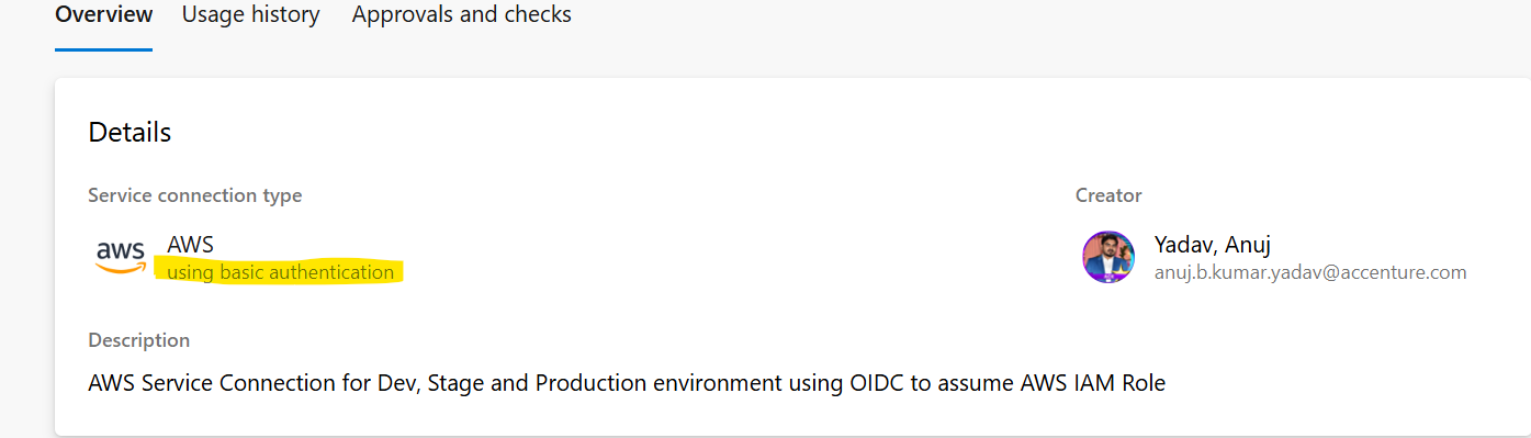

but my CD pipeline is not able to fetch the temporary session token and i noticed that the connection type is AWS and Authentication type is BASIC authentication.
Can you pls tell me how to create service connection with Workload Identity federation like what i can see currently for Azure resource Manager.
As per my understanding the Authentication Type should be 'Workload Identity federation' instead of Basic authentication..

- In the AWS Console go to IAM -> Identity Providers -> Click "Add Provider" -> Choose OIDC -> Set Provider URL to:
https://vstoken.dev.azure.com/{your-org-ID},
Audience: Set to:https://dev.azure.com/<your-org-name>

I have setup the Identity provider on AWS side, and created IAM role by using that Identity Provider, Also i have setup the trust relationship(attached)Also below is the trust relationship i have setup-

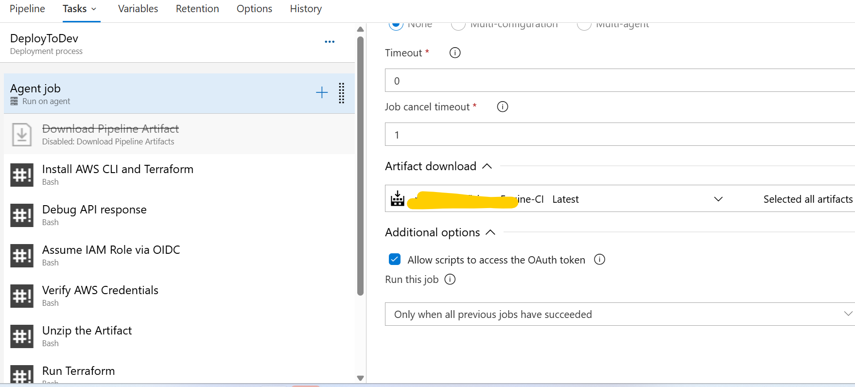

I have tried the above approach but the variable which is being used in manula assumption script- System.AccessToken gives the blank value. And even i tried creating Classic pipeline where i have option to enable "Allow scripts to access the OAuth token" but did not work.. i am in deadlock situation.
In Yaml when i get System.AccessToken value null then it suggests me to enable the option "Allow scripts to access the OAuth token" but i don't have option to enable this then somewhere i got to know that this option can be found in classic pipeline then i moved to classic and got this option but still not working.. i am stuck ..pls help..if you want i can share the code here- -

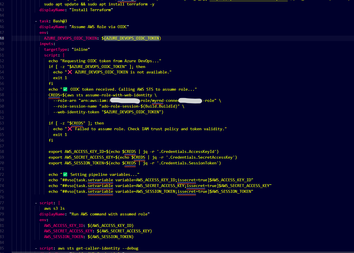

2025-07-02T05:31:02.5233333+00:00 This is the yaml code i am using to assume role manually-

If your pipeline is running in a release pipeline (not a build pipeline), the OAuth token behaves differently. Classic release pipelines don’t always honor the
System.AccessToken
the same way YAML or classic build pipelines do.In YAML File, you must explicitly map the token into the environment:
- script: echo "Token: $SYSTEM_ACCESSTOKEN" env: SYSTEM_ACCESSTOKEN: $(System.AccessToken)
Then reference it as
$SYSTEM_ACCESSTOKEN
in your script—not$(System.AccessToken)
.Hope this helps!
Please Let me know if you have any queries.

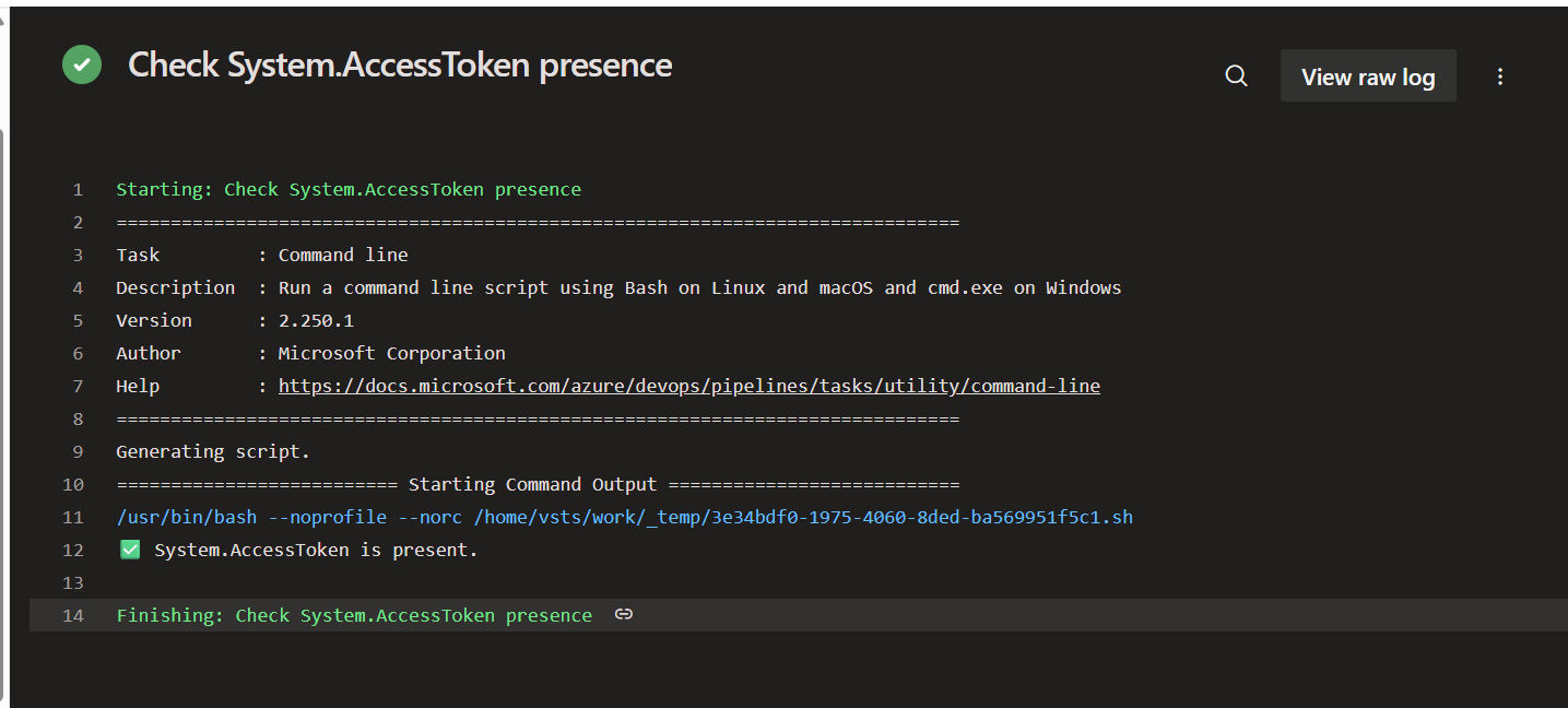

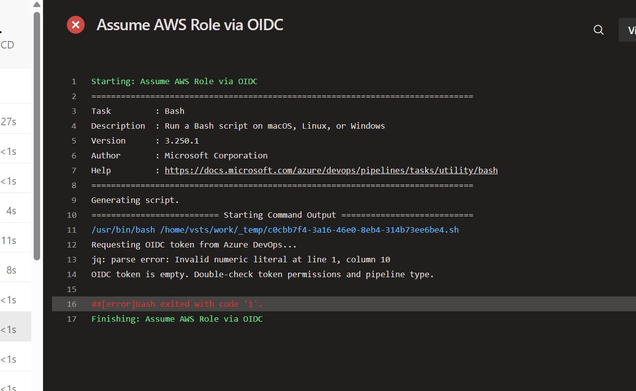

Yadav, Anuj • 0 Reputation points
2025-07-02T08:48:53.71+00:00 This is log after Checking System.AccessToken
The very Next Step:
Durga Reshma Malthi • 6,205 Reputation points • Microsoft External Staff • Moderator
2025-07-02T09:57:26.1133333+00:00 Hi Yadav, Anuj
Thanks for sharing the screenshots.
Ensure your project visibility must be private.
The error seems you're referencing
System.IdentityTokenURI
without proper syntax. In Bash, variables like that must be wrapped like${System.IdentityTokenURI}
but even then, they only work if passed explicitly into the environment block.Could you please try this YAML File:
- task: Bash@3 displayName: "Assume AWS Role via OIDC" env: SYSTEM_ACCESSTOKEN: $(System.AccessToken) inputs: targetType: 'inline' script: | echo "Requesting OIDC token from Azure DevOps..." OIDC_TOKEN=$(curl -s -H "Authorization: Bearer $SYSTEM_ACCESSTOKEN" \ "$(System.TeamFoundationCollectionUri)_apis/distributedtask/hubs/build/plans/$(System.PlanId)/oidc/token?api-version=7.1-preview.1" | jq -r .value) if [ -z "$OIDC_TOKEN" ]; then echo "OIDC token is empty. Double-check token permissions and pipeline type." exit 1 fi echo "Calling AWS STS to assume role..." CREDS=$(aws sts assume-role-with-web-identity \ --role-arn "arn:aws:iam::<your-account-id>:role/<your-role-name>" \ --role-session-name "ado-role-session-$(Build.BuildId)" \ --web-identity-token "$OIDC_TOKEN") if [ -z "$CREDS" ]; then echo "Failed to assume role. Check if token is valid and trust relationship is configured correctly." exit 1 fi export AWS_ACCESS_KEY_ID=$(echo $CREDS | jq -r '.Credentials.AccessKeyId') export AWS_SECRET_ACCESS_KEY=$(echo $CREDS | jq -r '.Credentials.SecretAccessKey') export AWS_SESSION_TOKEN=$(echo $CREDS | jq -r '.Credentials.SessionToken') echo "Setting pipeline variables..." echo "##vso[task.setvariable variable=AWS_ACCESS_KEY_ID;issecret=true]$AWS_ACCESS_KEY_ID" echo "##vso[task.setvariable variable=AWS_SECRET_ACCESS_KEY;issecret=true]$AWS_SECRET_ACCESS_KEY" echo "##vso[task.setvariable variable=AWS_SESSION_TOKEN;issecret=true]$AWS_SESSION_TOKEN"
Alternatively, try this
Replace OIDC_TOKEN=$(curl -sSL -H "Authorization: Bearer $(System.AccessToken)" "$(System.IdentityTokenURI)?resource=https://dev.azure.com/")
with:
OIDC_TOKEN=$AZURE_DEVOPS_OIDC_TOKEN
and adjust in the yaml file as required:
env: AZURE_DEVOPS_OIDC_TOKEN: $(AZURE_DEVOPS_OIDC_TOKEN)
Hope this helps!

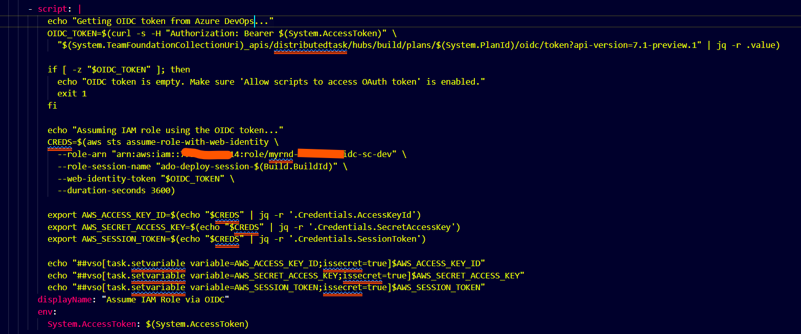

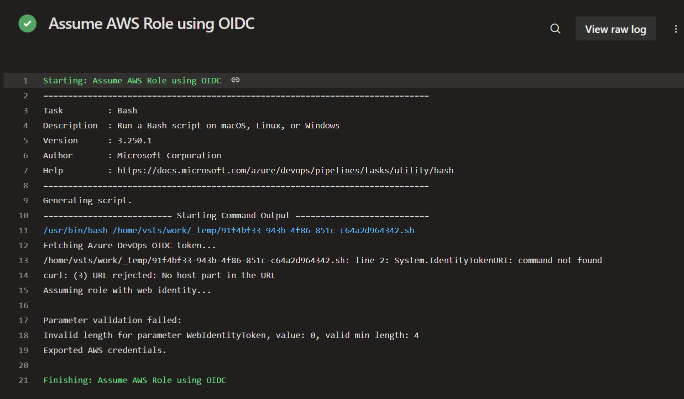

2025-07-02T10:11:41.7233333+00:00 -

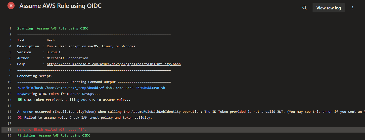

2025-07-02T10:23:01.83+00:00 Error getting-
2025-07-02T11:11:07.1366667+00:00 One quick Question: Why the Feature: Service connections-> AWS-> Workload Identity Federation (OIDC) is not enabled at my org or project level for AWS? I can see it is there for ARM .. has Microsoft disabled this feature or what is the reason?
How to get this enabled?

2025-07-02T11:21:19.5933333+00:00 Hi Yadav, Anuj
Microsoft removed the AWS OIDC option from the Azure DevOps UI and service connection wizard.
The AWS Toolkit for Azure DevOps (v1.15+) still supports OIDC behind the scenes, but it requires manual configuration via pipeline tasks not through the service connection UI.
Hope this helps!

Also make sure your AWS IAM Role has a trust policy like this:
{ "Effect": "Allow", "Principal": { "Federated": "arn:aws:iam::<your-account-id>:oidc-provider/vsts.azure.com" }, "Action": "sts:AssumeRoleWithWebIdentity", "Condition": { "StringEquals": { "vsts.azure.com:sub": "org:<your-org-id>:project:<your-project-id>:pipeline:<pipeline-id>" } } }
Alternatively, try the below yaml file as well:
- task: Bash@3 displayName: "Assume AWS Role via OIDC" inputs: targetType: 'inline' script: | echo "Reading OIDC token from environment..." if [ -z "$AZURE_DEVOPS_OIDC_TOKEN" ]; then echo "OIDC token is empty. Make sure this pipeline is in a private project." exit 1 fi echo "Calling AWS STS to assume role..." CREDS=$(aws sts assume-role-with-web-identity \ --role-arn "arn:aws:iam::<your-account-id>:role/<your-role-name>" \ --role-session-name "ado-role-session-$(Build.BuildId)" \ --web-identity-token "$AZURE_DEVOPS_OIDC_TOKEN") export AWS_ACCESS_KEY_ID=$(echo "$CREDS" | jq -r '.Credentials.AccessKeyId') export AWS_SECRET_ACCESS_KEY=$(echo "$CREDS" | jq -r '.Credentials.SecretAccessKey') export AWS_SESSION_TOKEN=$(echo "$CREDS" | jq -r '.Credentials.SessionToken') echo "Setting pipeline variables..." echo "##vso[task.setvariable variable=AWS_ACCESS_KEY_ID;issecret=true]$AWS_ACCESS_KEY_ID" echo "##vso[task.setvariable variable=AWS_SECRET_ACCESS_KEY;issecret=true]$AWS_SECRET_ACCESS_KEY" echo "##vso[task.setvariable variable=AWS_SESSION_TOKEN;issecret=true]$AWS_SESSION_TOKEN" env: AZURE_DEVOPS_OIDC_TOKEN: $(AZURE_DEVOPS_OIDC_TOKEN)
If possible, could you please share the YAML File in private message
Hope this helps!
2025-07-03T08:34:58.1966667+00:00 -
