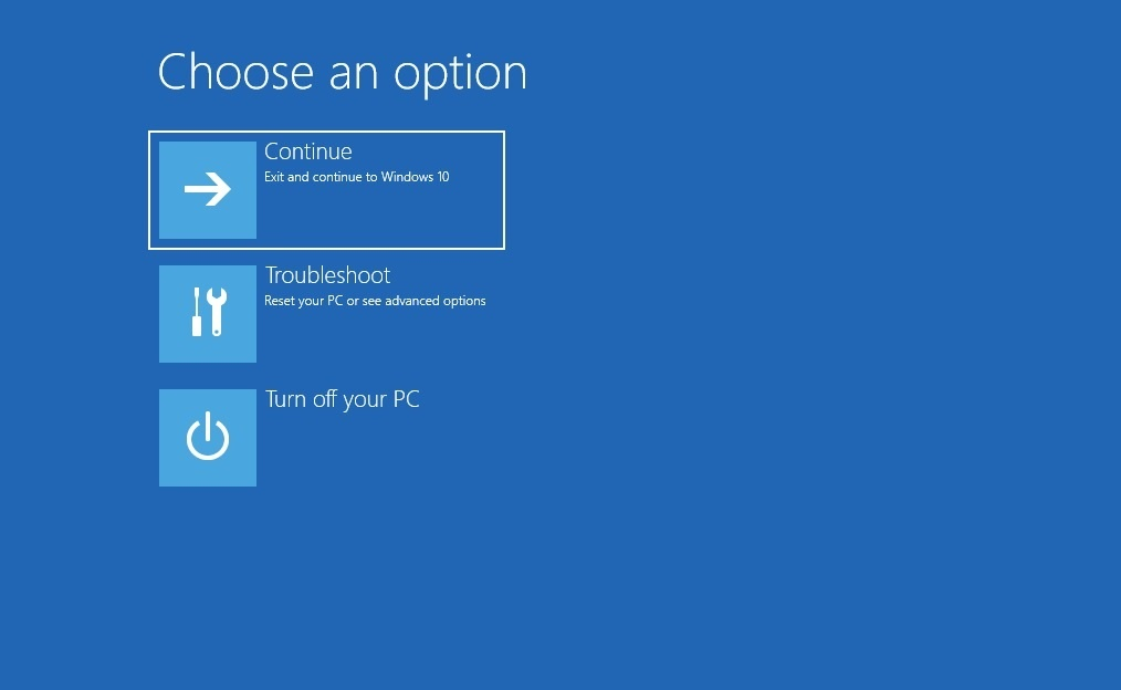

Step 1: Boot to the Recovery environment To boot to WinRE, from where Windows can trigger the MBR2GPT tool, please see the steps below:
On the Lock screen, press and hold the Shift key while choosing Restart from the Power menu. Continue pressing the shift key until you see the Windows Recovery environment, asking you to select an option.
1
Click Troubleshoot>Advanced options>Command Prompt.
The computer would restart.
Login to your account.

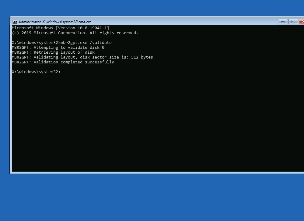

Step 2: Validate if the MBR2GPT tool can convert your disk
On the Command Prompt Window, our next step would be to check if the tool can convert the disk to GPT. To do this, execute the following command:
mbr2gpt.exe /validate
The output should tell you if the validation is successful. If the disk is validated, conversion is possible.

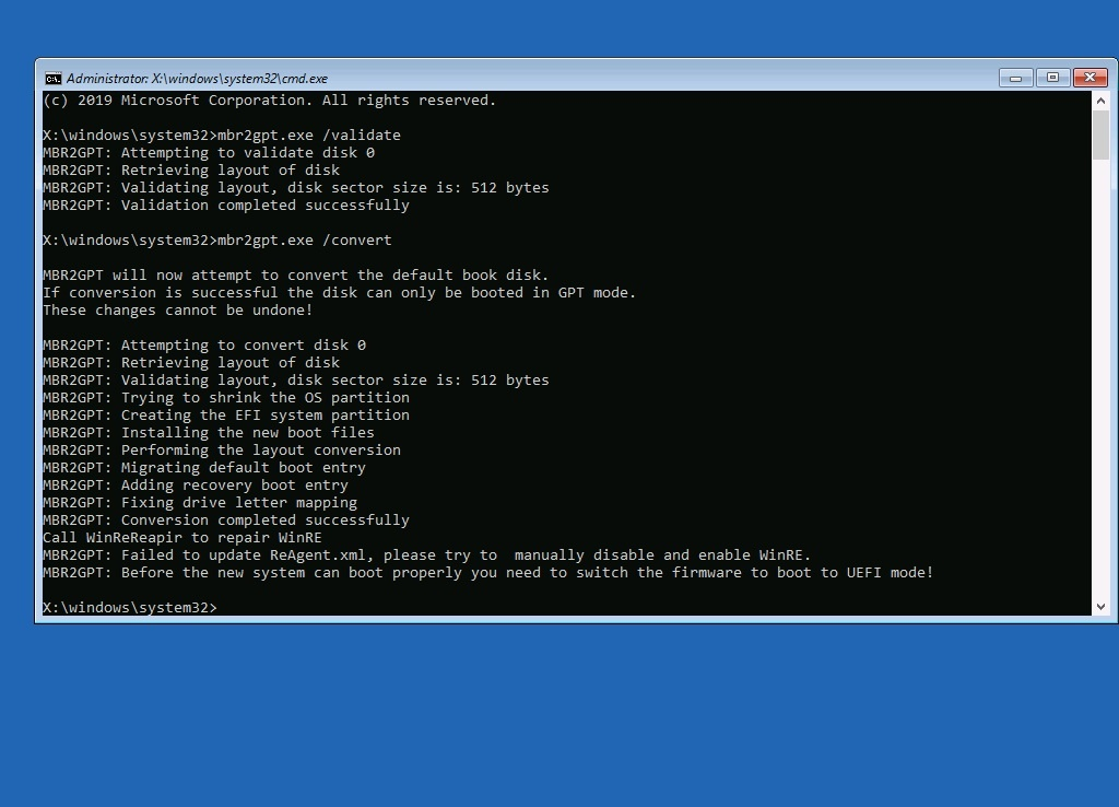

Step 3: Convert the disk.
The next step is to convert the disk. For that, use the /convert switch.
mbr2gpt.exe /convert
The process would take some minutes and tell you the output.

  1. Dominik 5 Reputation points
    2025-09-22T18:23:15.1366667+00:00
    There is one crucial step missing: The target disk must have around 200/300MB of unallocated space available. You can achieve that by opening the disk management tool in Windows and then reducing the size of the system partition by 300 MB. Otherwise conversion will fail with error 0x000036B7 (despite the validation being succesful) and it will brick your Windows
