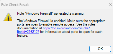

The error pop-up sends me to a page titled, "Configure the Windows Firewall to allow SQL Server access"
I was able to complete the PowerShell commands to open TCP port 1433 and UDP port 1434 for SQL Server, in that no errors were displayed.
I reran the installation with the same error.
What else can I try? Seems I just need to open the ports for the firewall.

    As Olaf says, the message about the firewall is just a warning. It has no relation to your installation failure.
