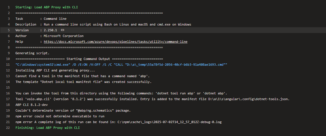

The deployment of an ASP.NET Core application consists of a backend using the ABP framework and a frontend built with Angular, stored in a single repository on Azure DevOps. A YAML pipeline has been configured to deploy both components to separate Azure Web Apps (Windows). The backend app deploys successfully, but the frontend app fails to build and release correctly.
Key Requirement: Before building the Angular app, the proxy must be generated using the ABP CLI. The pipeline does not generate this proxy during execution, which is essential for type safety and IntelliSense support in Angular when handling API calls.
Below is the YAML script configuration for the pipeline:

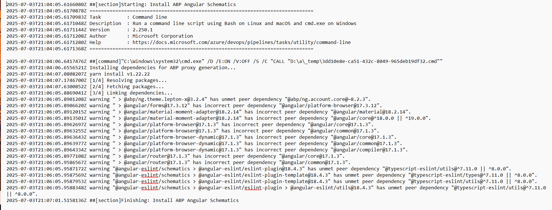

    - script: |
        cd angular
        npm install -g yarn
      displayName: 'Install Yarn'

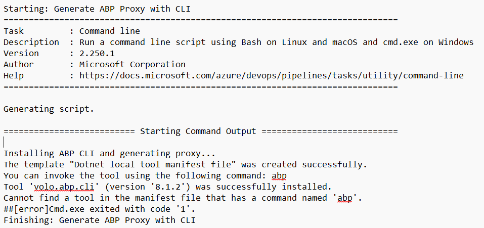

    # Run ABP CLI from cmd.exe to generate Angular proxy
    - task: CmdLine@2
      inputs:
        script: |
          cd angular
          echo Installing ABP CLI and generating proxy...
          call dotnet tool install -g Volo.Abp.Cli --version 8.1.2
          abp generate-proxy -t ng -u
      displayName: 'Load ABP Proxy with CLI'

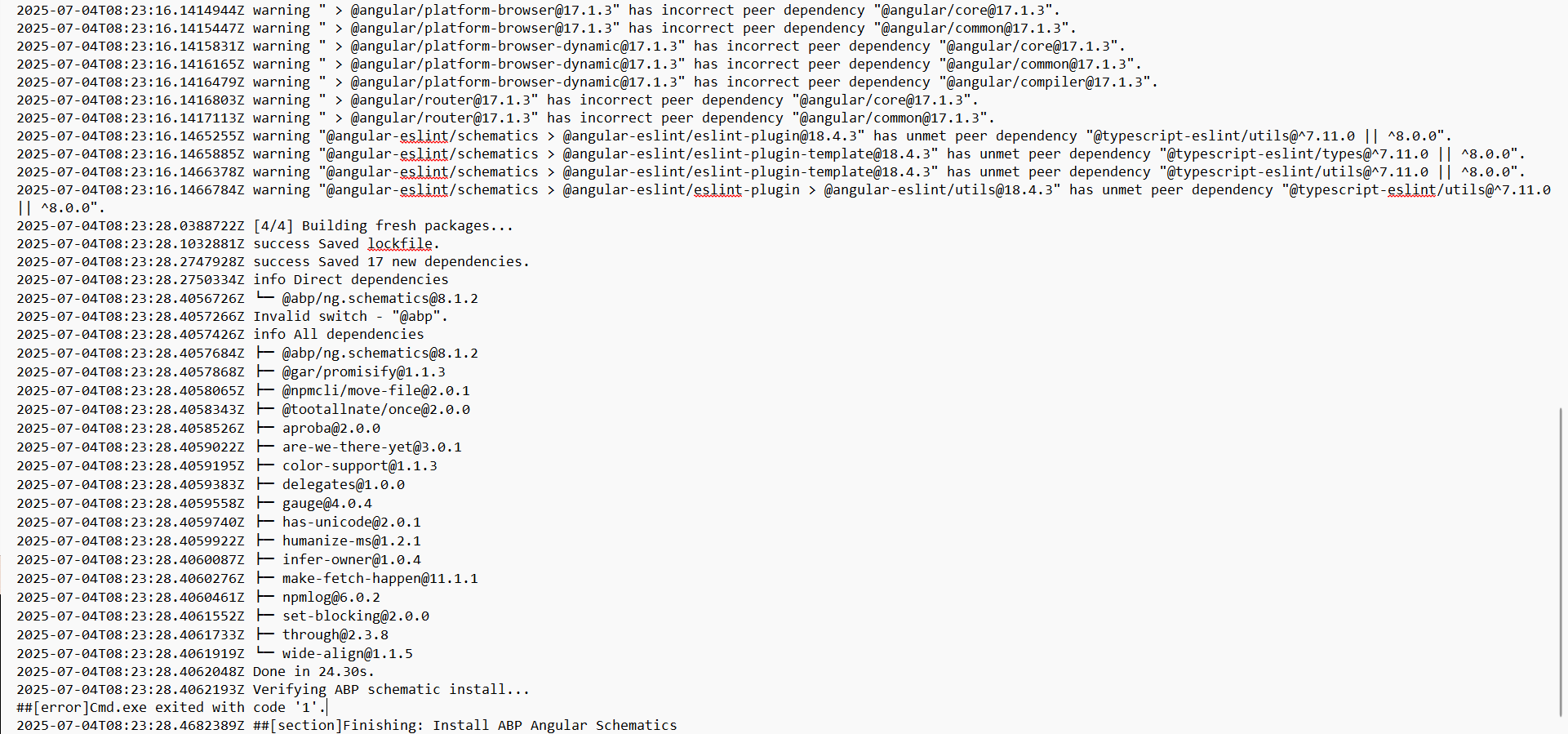

    - script: |
        cd angular
        echo "Installing Angular dependencies via npm..."
        ng config -g cli.packageManager yarn
        yarn add @angular/cli
        yarn add install-peers
        ng build --configuration production
      workingDirectory: '$(angularDir)'
      displayName: 'NPM Build Angular App'
