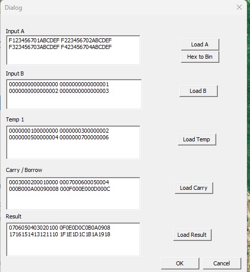

This app does some 512 bit arithmetic using an array of uint64_t.  It displays the numbers, in hex, in Edit controls.  Below is the lowest level of my code that does the hex display. lp_cedit points to the edit control. lp_binary points to an array of ints, uint64_t.

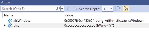

The very first time the code attempts to display anything, in the debugger, at the Clear function, the Autos panel shows:
clear1

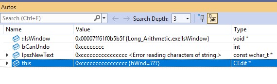

Step into the Clear function to see
clear2
The Autos display looks bad, but it does not assert.  Visual Studio makes no sound.

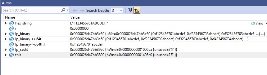

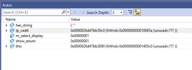

Step out and down to the first call to ReplaceSel to see
replace1
Looks OK to me.  Step in to find the below
This looks bad. BUT it writes to the edit control.  Until the Edit Control is full of text.  They are set to no scroll.  Then the Clear() does nothing, does not assert, and the ReplaceSel() does nothing but it does assert.
