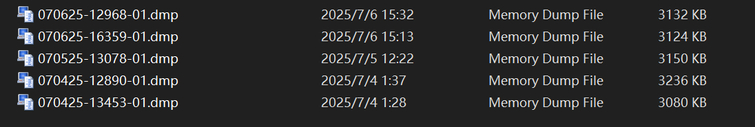

  3. Alexandr S 155 Reputation points Independent Advisor
    2025-07-06T10:15:23.9833333+00:00
    Unfortunately, only two dumps are available at the link: 070525-13078-01 .dmp (already processed earlier) and 070625-12968-01 .dmp. OneDrive has been working incorrectly for many lately. Please pack all 4 dumps into one archive.zip and write the link to the archive.
