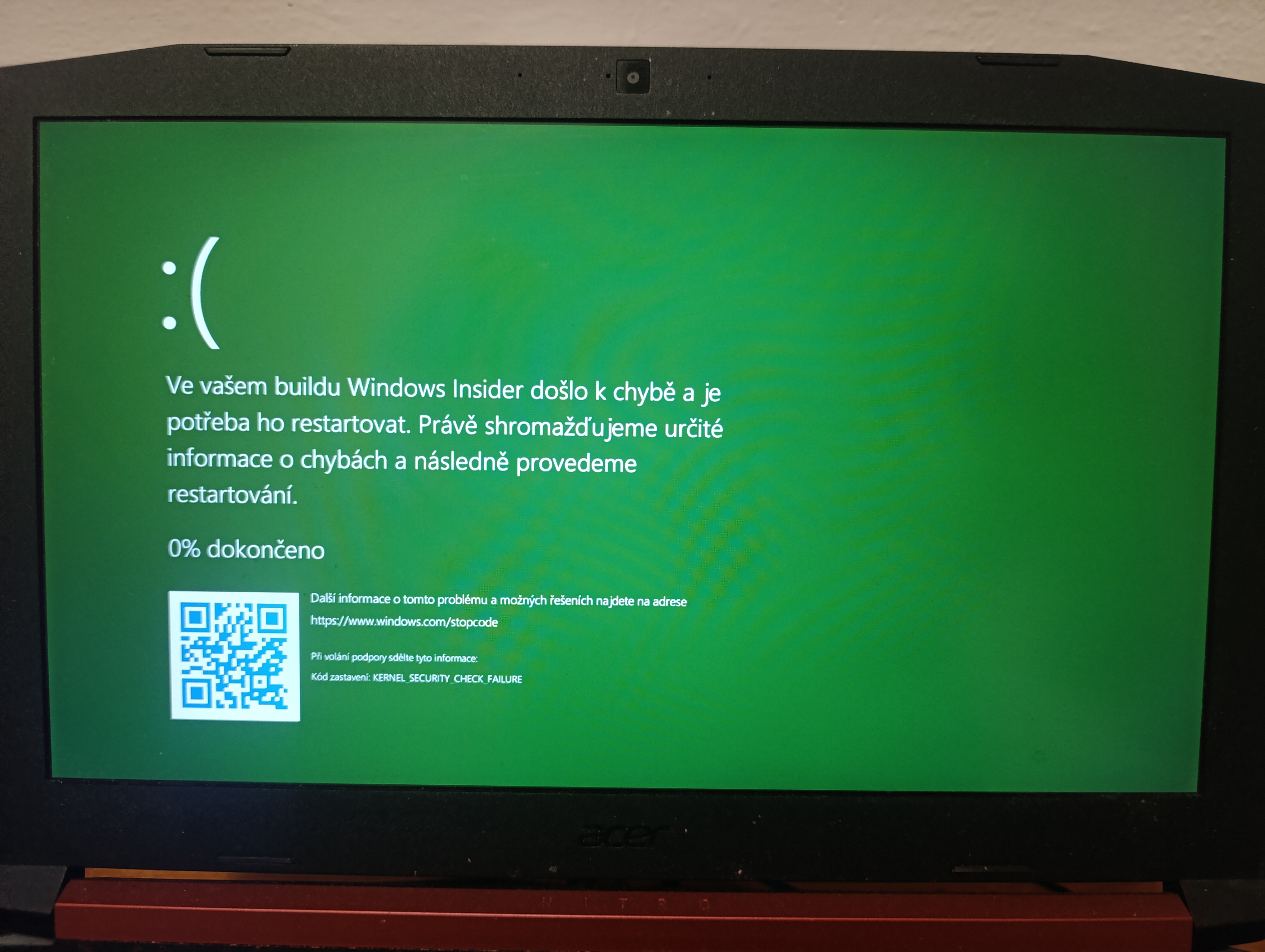

I've managed to get my hotspot from my Ethernet cable connection up and running, and my phone connects to it just fine. I need that hotspot because my dormitory wifi is really weak in my room and thus isn't stable. However, when I try to connect my Arch Linux laptop to my hotspot on Windows 11, it instantly causes BSOD with stopcode "KERNEL_SECURITY_CHECK_FAILURE".
BSODs back in Windows XP days used to be much more informative, and if you were quick enough (or the PC was slow enough) for you to snap a picture of the screen with your camera, you'd be able to analyze exactly in which part of the memory the error happened, which triggered the bugcheck. That's no longer possible, where you have to use a vague stopcode and a MEMORY.DMP file that contains the dump of the memory produced by the bugcheck procedure.
My MEMORY.DMP file is 2.5 GB big, and I suppose it's not even complete (that may be because I've got 16 GB RAM). I'm not sure if bugcheck only dumps the portion of the memory where an error occured, but 2.5 GB seems a little bit too small for a memory dump to something that supposedly was in the kernel. What I can however suspect is that Wi-Fi drivers might be at fault, or perhaps Windows modules for managing Wi-Fi hotspot.

This is the picture of the BSOD (in my case, the screen is green, because I'm using an Insider Preview - GSOD).
The percentage didn't move at all, it stayed at 0% the whole time, it was like 5 minutes. I'm not waiting hours for it to move, I need to use the PC.

    No, it's not a phone hotspot, it's a hotspot from my gaming laptop. This is my setup: I've got 3 devices. An Android phone, and two laptops: gaming laptop with Windows 11, and travel laptop with Arch Linux.
    My gaming laptop is connected to the Internet via an Ethernet cable, through my university network. This is the origin of my Wi-Fi hotspot. My gaming laptop broadcasts that hotspot. My phone and my travel laptops are clients that want to connect to it. While my phone connects to the hotspot just fine, my travel laptop crashes my gaming laptop instantly when connecting. The stop code is KERNEL_SECURITY_CHECK_FAILURE. That implies there is a driver issue that affects the Windows kernel security.
