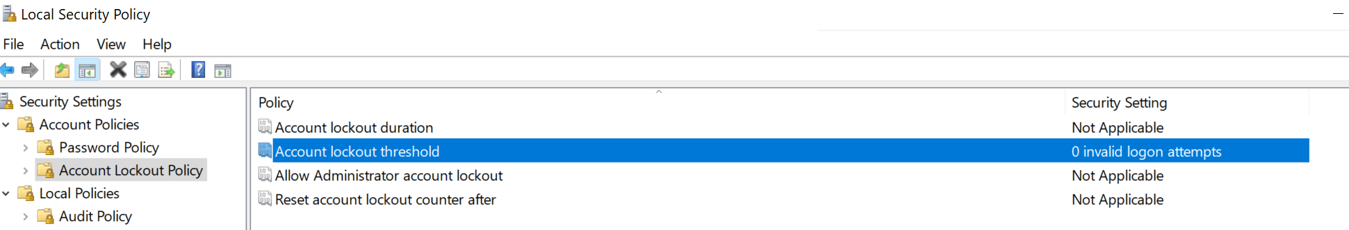

    also check this is set to Zero

    I've changed the PIN to a password and it seems okay at the moment. I've not had much time so I'll check that setting later.
    Thanks for the suggestion.
