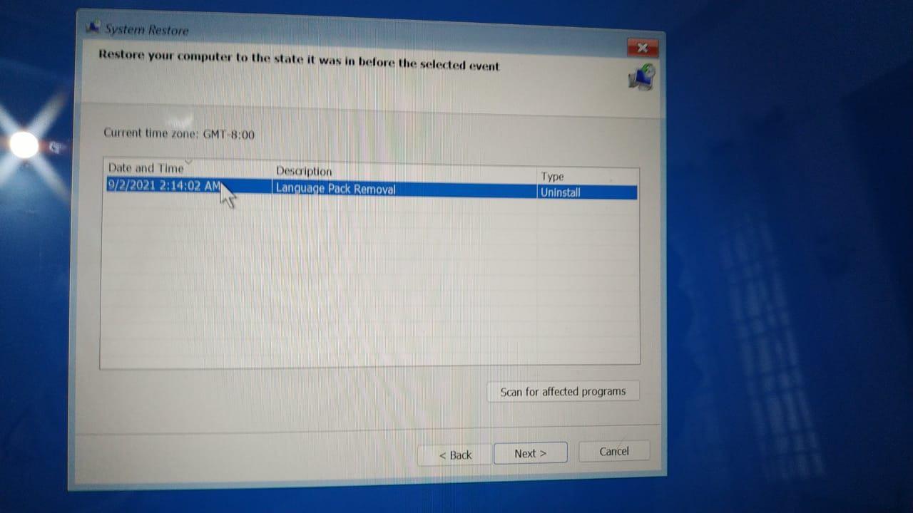

    However, before I got the above fix, I tried to restore my laptop prior to *Language Pack Removal* (which I installed yesterday - please see the image below) and things are working fine now. Don't know if this is the real issue, nevertheless wanted to posted what worked for me.
    Thanks & Regards,
    Kiran.
  4. Sumit 42,926 Reputation points Volunteer Moderator
    2021-09-03T06:11:09+00:00
    Yes, in a way you removed the offending IrisService causing the issue, using a system restore.
