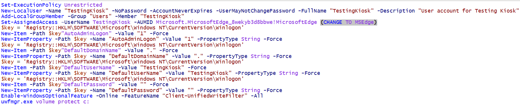

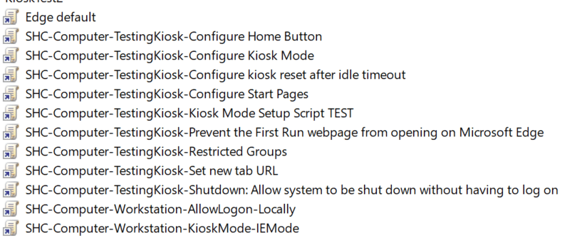

    Our setup, we have GPOs applied to our Training computers. One of the GPOs specifies which PS script to run. In this it informs the computer to autologin, with a specific username, only using Edge Legacy while opening up 3 tabs of important URLs that pertain to the training computers.
    With the update pushed, the training computers are still attempting to call the Legacy Edge. We went in and changed the AUMID from Microsoft.MicrosoftEdge_8wekyb3d8bbwe!MicrosoftEdge to MSEdge. This did not solve the issue by simply redirecting the string to call MSEdge oppose to Legacy. I would think this would be as simple as replacing which app the script calls. Maybe there are additional steps but we have yet to find a solution.

    We also have multiple other GPOs set per the 70+ computer assets to configure exactly as the customer needs.
    Here is our PS script that runs on each of the machines. See below for the GPOs applied per computer.
