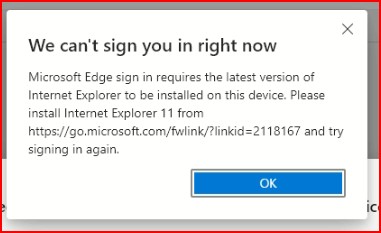

We can't sign you in right now
Microsoft Edge sign in requires the latest version of Internet Explorer to be installed on this device. Please install Internet Explorer 11 from https://go.microsoft.com/fwlink/?linkid=2118167 and try signing in again.
I keep getting this error and have not been able to find a way around it.
I mean really, why do i still need to have IE 11 installed, c'mon Microsoft this is ridiculous and totally stupid.
How can I resolve this issue?

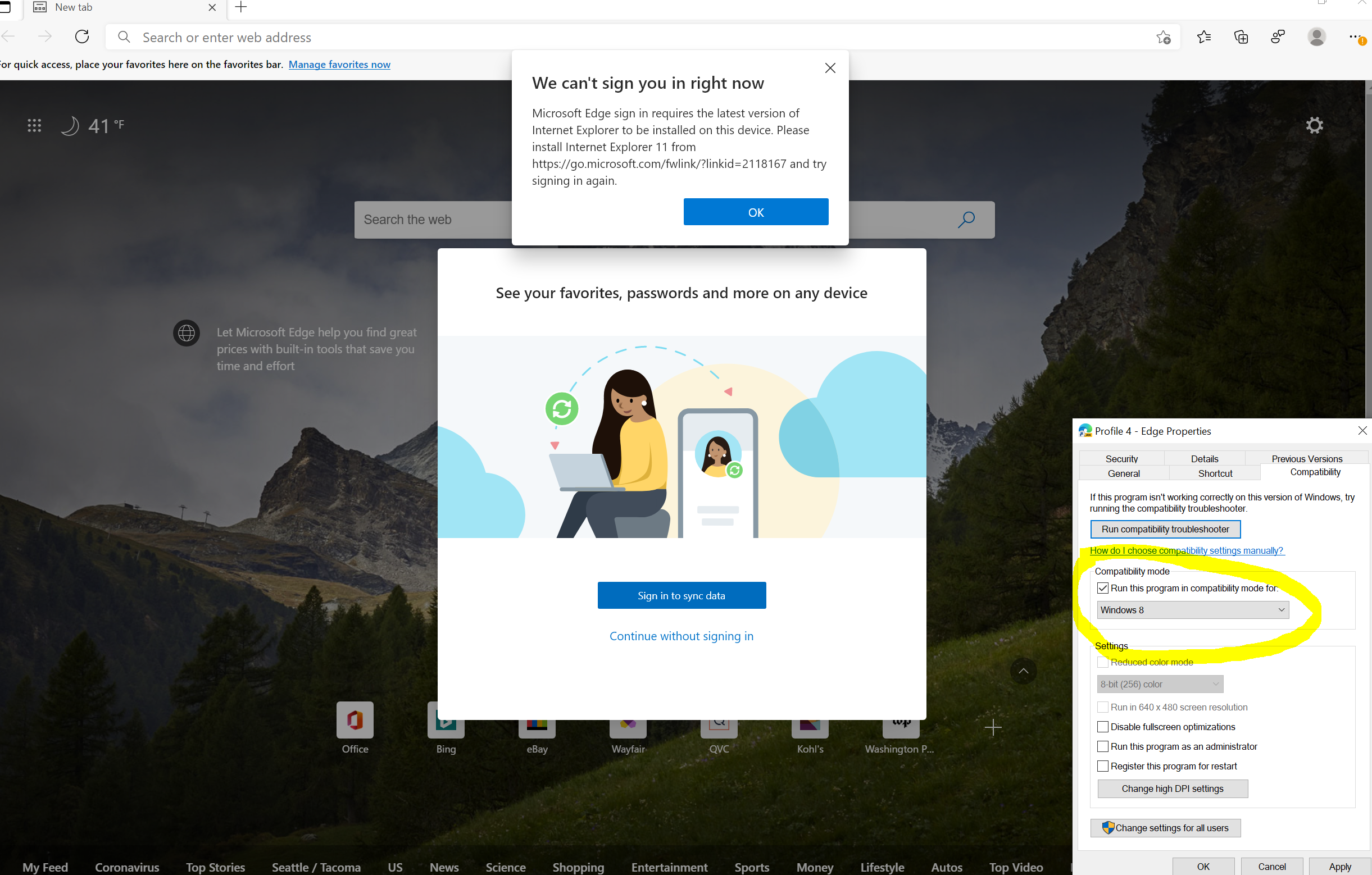

    Thanks for your patience!
    The team has looked into this issue and determined this is related to Compatibility mode. On Windows 10 if Edge is configured to run in Compatibility mode as Windows 8, you will see this error. This is not a supported configuration to run Edge on Windows 10.
    The fix for this is to turn Compatibility mode off (right click on Edge from the File Explorer > Properties > Compatibility tab > Uncheck "Run the program in compatibility mode for:")
